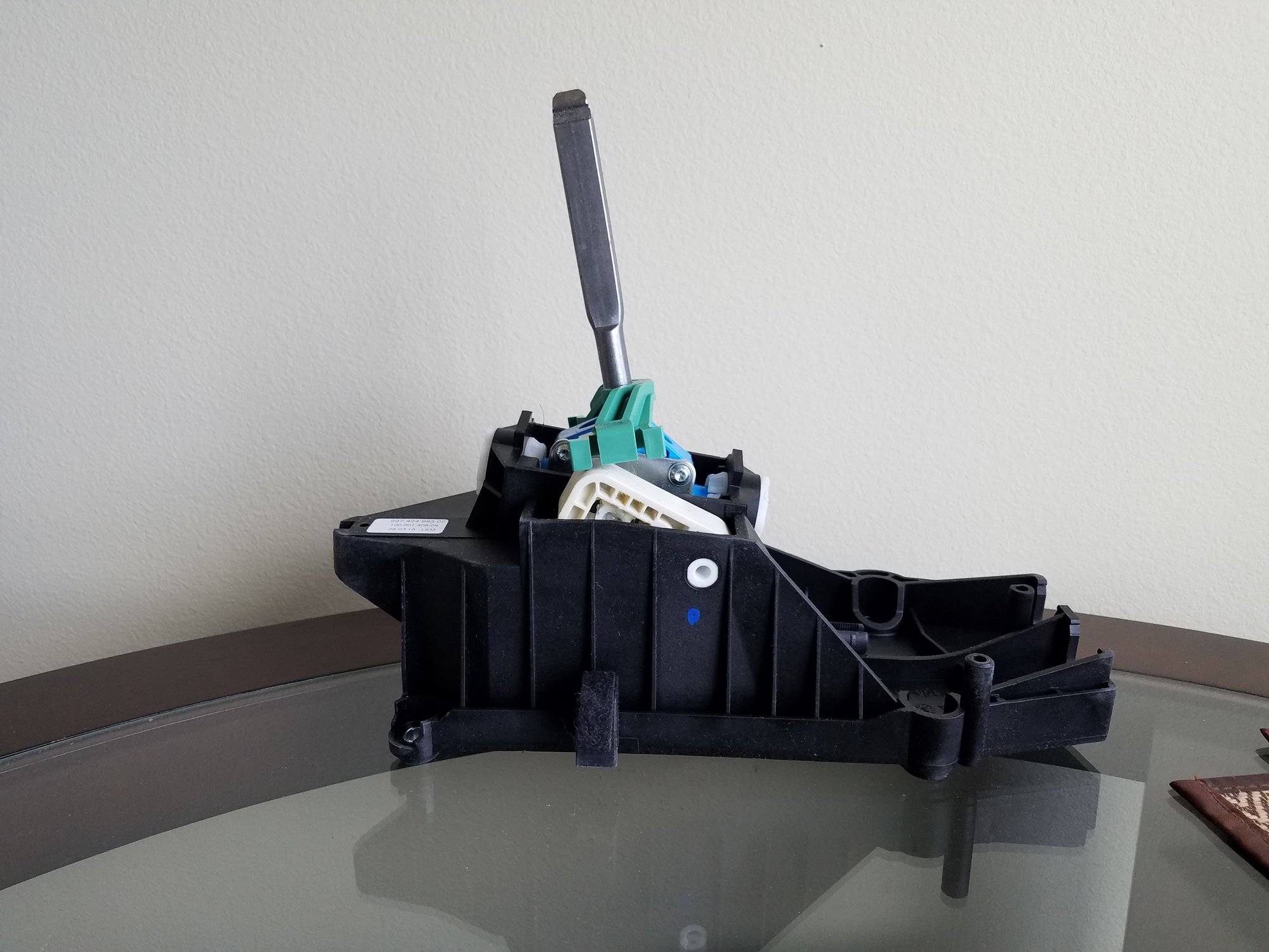

Just reread your post and want to clarify. Mine is the standard 997 shifter assembly bought from Leith Porsche.
The part number you posted is the Porsche short shifter kit which I didn’t get a quote for.
The standard shifter assembly also come with the green bracket to help you install the cable correctly.
