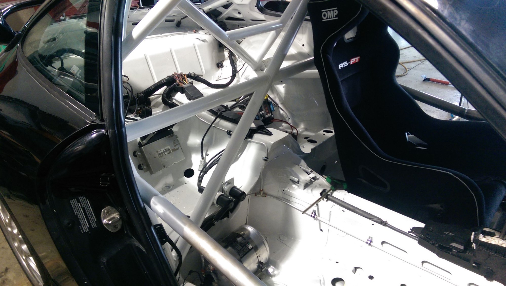

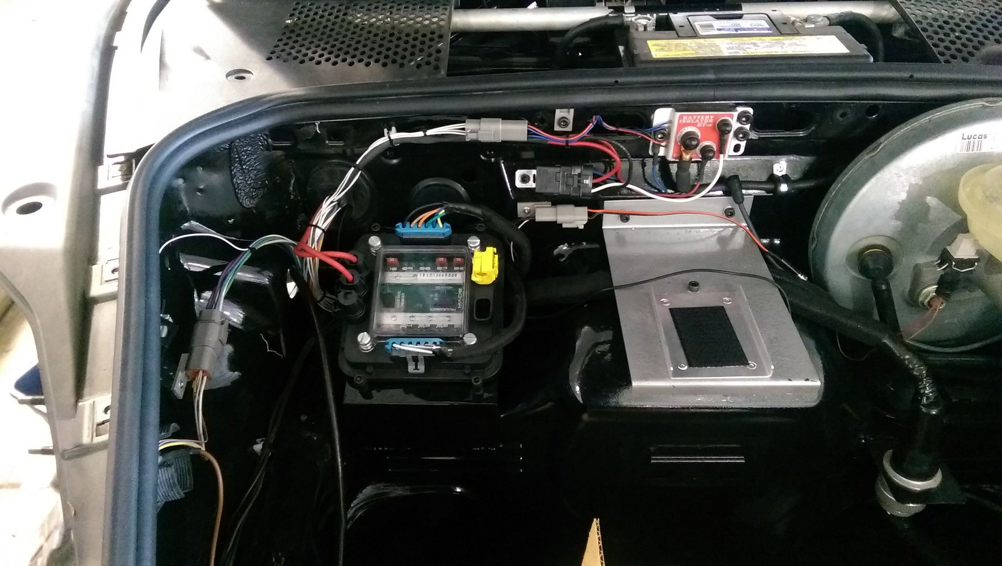

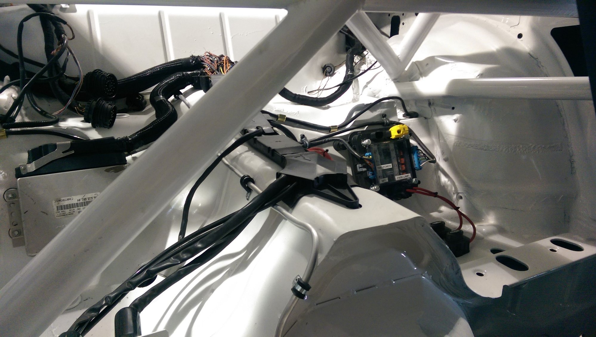

Quote:
Looks like a fun project. I went through the same issues with wireing but went a different way
I'm gonna need a NSFW tag on this. ...drool
