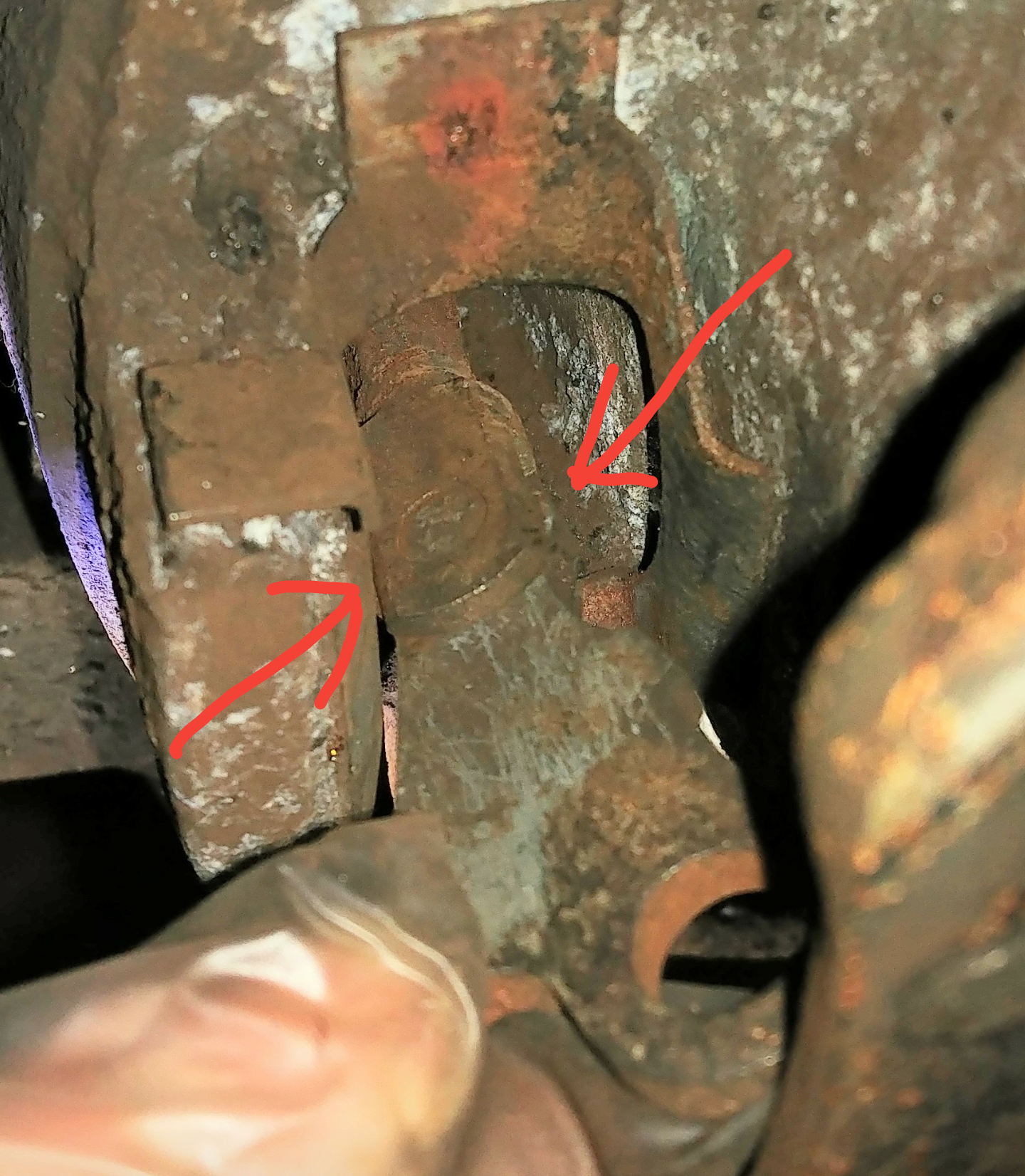

Hey everyone. I've been working on refreshing brakes, shocks, springs and wheel bearings on my '03 C4S. I'm trying to remove the rear wheel hub but am stumped - can't figure out how to get the "fork" separate from the parking brake cable so I can pull it out from that hard cable sleeve/tube in the back of the hub. Got the parking brake components disassembled otherwise with no problem. It's just this fork piece that's holding me up. Any ideas?

Thanks Slakker, am I looking at this wrong then? Can the cable only pull towards you and that "fork" I pictured does not get disconnected at all? It seems like this would be so much easier to do it from this end.

I just replaced both my parking brake cables... That pin that's holding the connector on (in the photo with the red arrows) comes out with a punch. It's just an interference fit - spray it with a little WD-40 or PB Blaster and it'll come right out.
Perfect! I will try punchin' and blastin' it tonight.

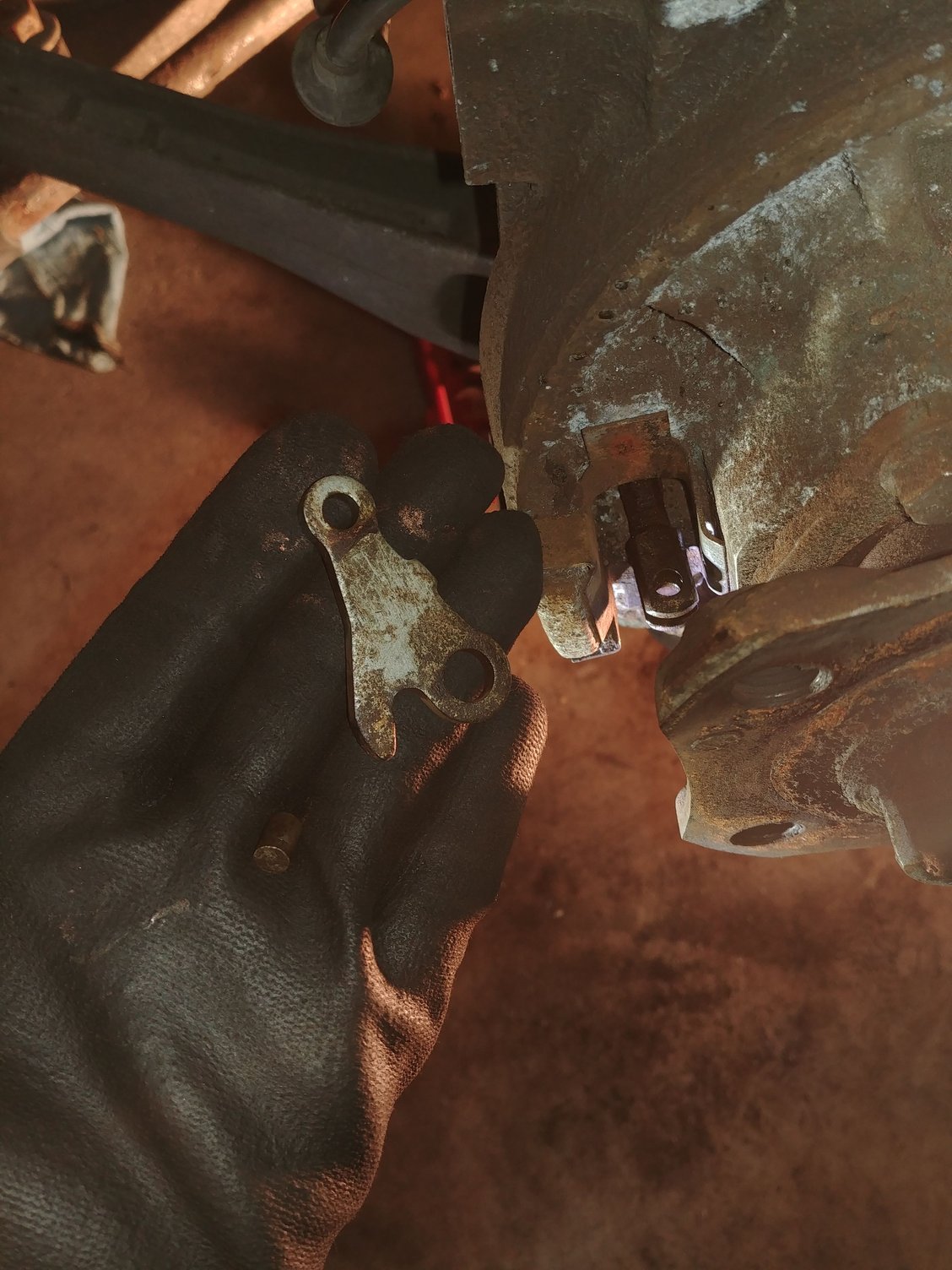

I let it soak in PB for about 10 minutes and the pin fell right out. No punching required. Thanks guys!
