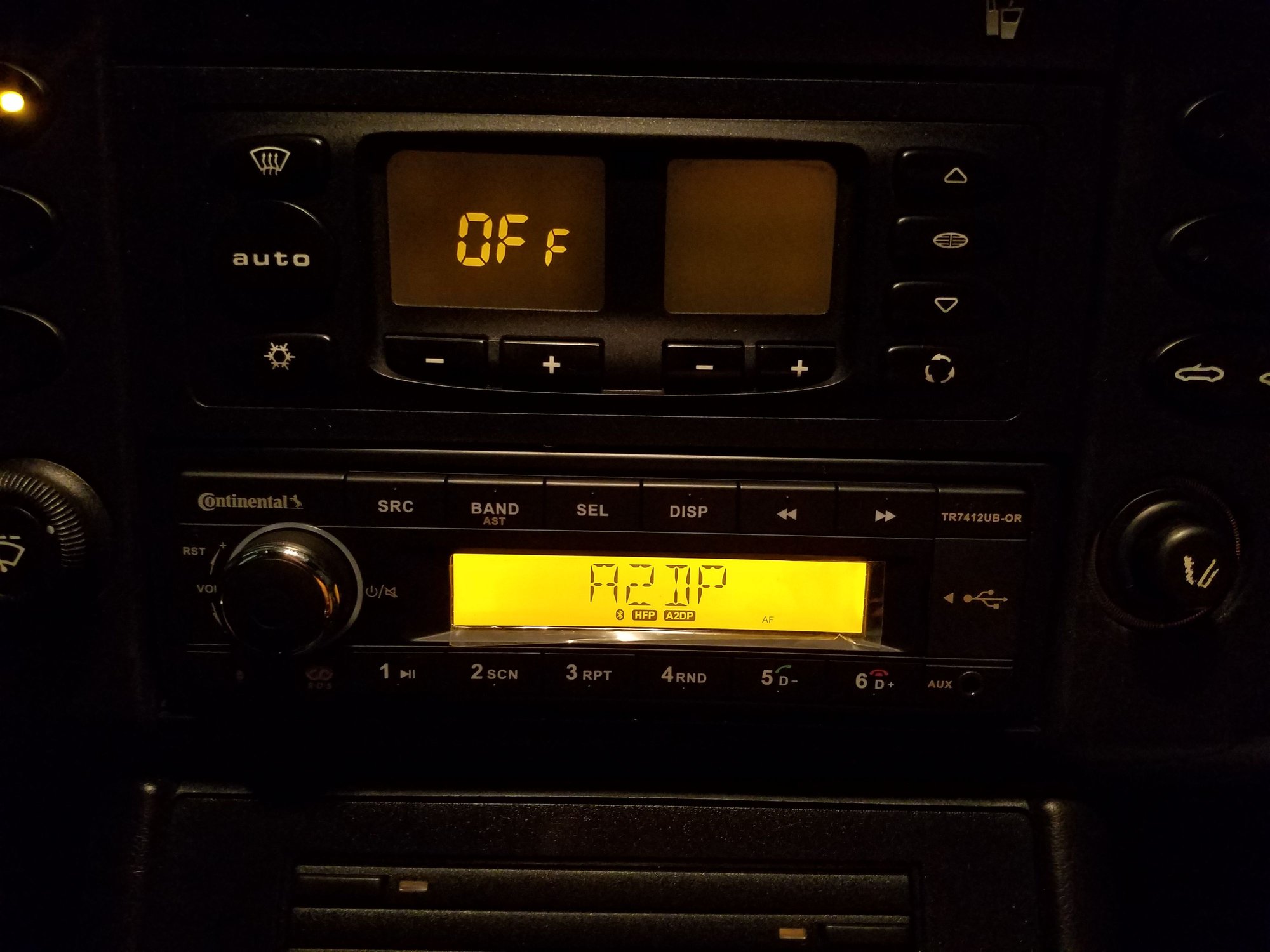

Last week I moaned about how my new Continental tr7412ub stereo from Becker in NJ had no sound. Well that was my fault, the unit had been re-wired with a new harness and I did not understand exactly how to hook it up, But after a short discussion with Tom at Becker I had it installed and working perfectly in 5 minutes...Totally plug and play. This is a custom made harness and he has only done a few, but I bet he would be happy to do more. You do loose the CD changer but you gain Blue Tooth, USB, Aux in, and microphone. With no cutting or adapting anything, and I think it looks pretty good
This set up will work in 01-02 996 with cdr220/cr220

Yes it does have a Frunk Amp and that was the problem, I did not realize that there was a separate wire that sends power to the amp and I actually cut it off thinking it was for Steering wheel controls that I do not have. luckily I left enough wire to re-attach it.

unfortunately I did not but I believe the blue power wire in plug A? is spliced with a blue wire to a yellow female connector that the yellow C3? male plugs in to, this powers the Amp which was the extra yellow receptacle I did not understand.
