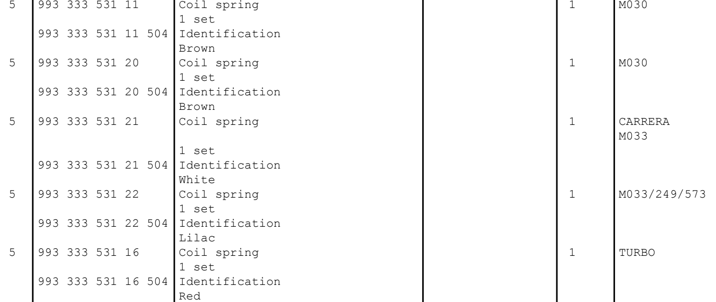

My version of PET shows 993.333.351.16 is the rear spring for Turbo. It also shows both 993.333.531.11 & 993.333.531.20 for M030. So I am assuming what you were told is correct? The M030 springs are the same regardless of trim, is my understanding. Shocks may be different?
Edit: had this backwards turbo uses different springs not shocks. So Turbo should be M030 shock with a Turbo spring (red dots).

That doesn't make any sense. Both Elephant Racing & Pelican Parts is saying the same part number. I also identified this part number. Which part number did you find?
I think the distinction here is that all Turbo models came with M030 shocks w/ turbo springs, while lower trims used M030 shocks with M030 springs. Whether or not the part number I supplied for Turbo rear springs has superseded, I do not know. If I have time I will ask the local dealer.

993 333 531 16 504 goes to 993 333 531 25 504 Red dots, only for turbo

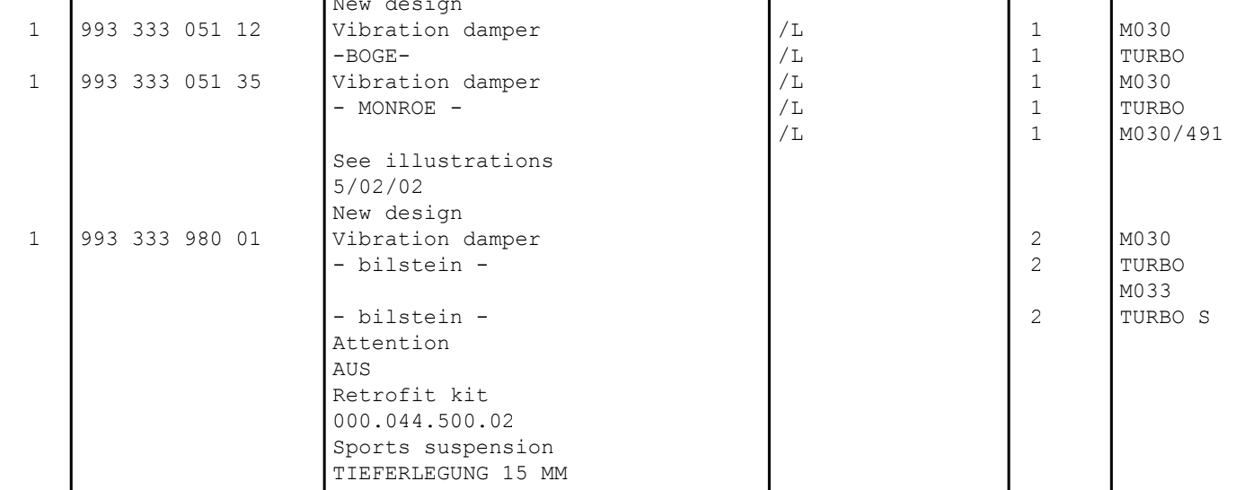

If you look in PET the shocks that are correct for M030 are also correct for Turbo, the springs have a separate option for Turbo and M030. I can also tell you that the Turbo S used RS engine mounts & some suspension parts too.

That is correct there is no soft/ stiff spring or shock options for turbo. It is an M030 shock with a turbo spring. Also note, these shocks are NLA and are replaced by the Sport Classic shocks now.
