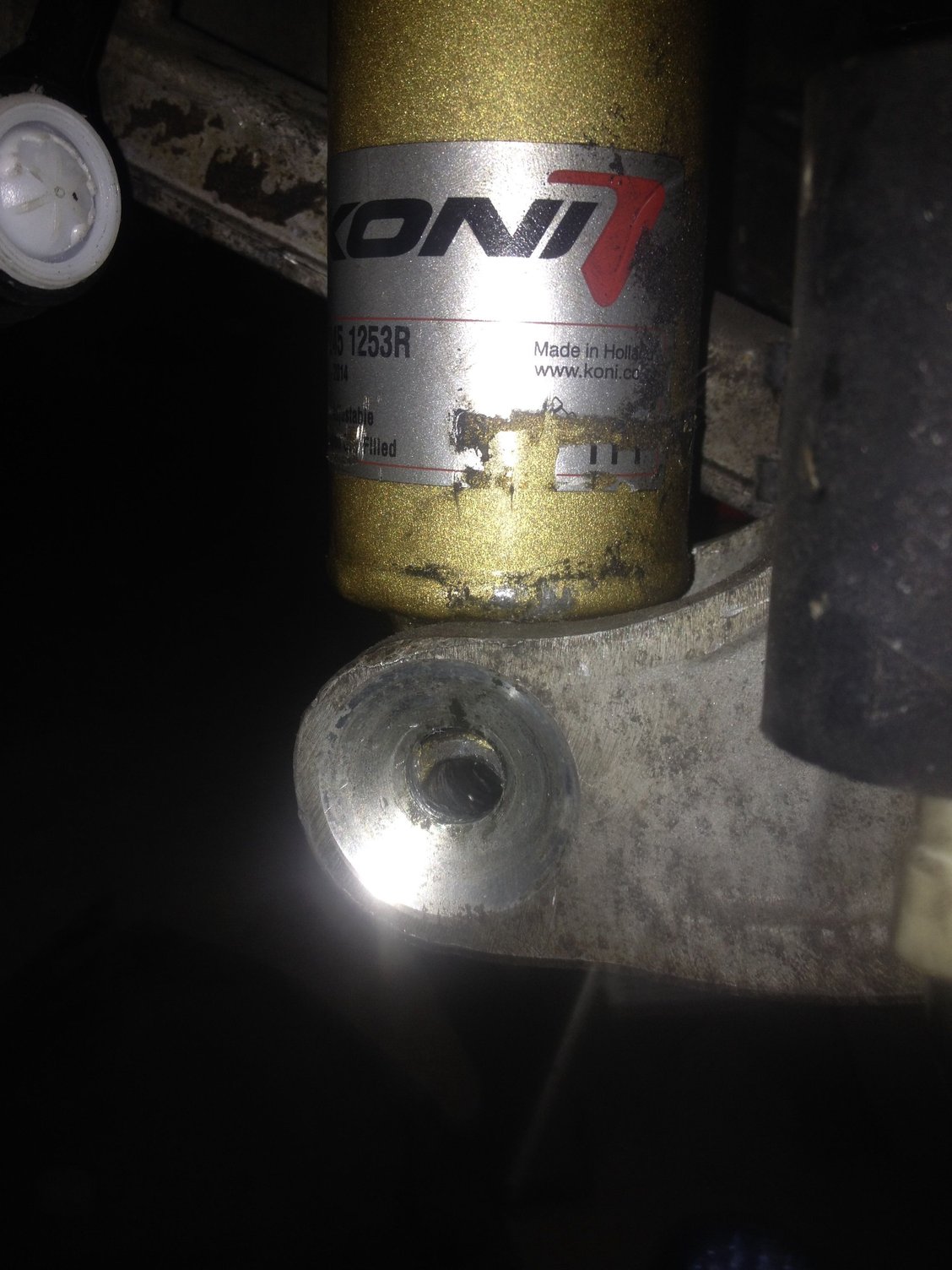

I can get this aligned by raising wheel hub
Side nearest front still off..
​​​​​​​Hi folks I'm trying to put shocks on but I'm finding that on side nearest back with coercion I can get hole lined up but side towards front if car is misaligned.
Ive trued jacking the hub but it's as though the shock angle is different to the hub.
do I need to undo all the suspension arms? Any tips greatly appreciated!

Sorted - loosened off arm above and it worked out. Will be doing a full geometry check afterwards anyway.
Yes - related. Just about to post in there to close it with good news
