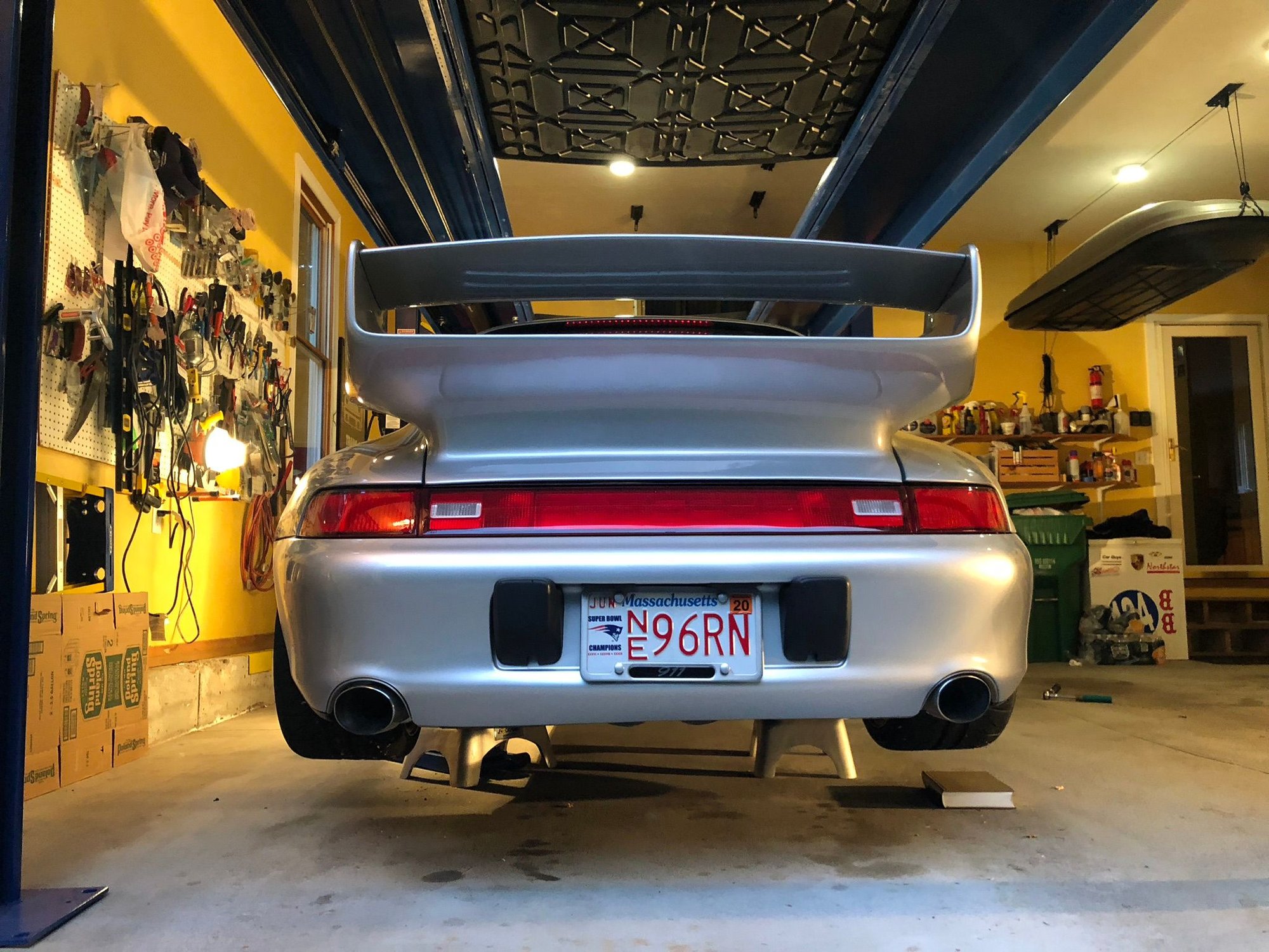

Very happy with my Jack Point Jack Stands. Makes quick work of wheel off brake bleeds. And easy enough to raise the height by placing a board of wood underneath. They’re safe and solid.
Best of both worlds is one pair of Jack Point Jack Stands, and one pair of Escos. You can jack the car from the rear using the Jackpoint and simply slide the Escos under the front while up there.
Jack up the rear with a jack point and you can slide an Esco (or another jackpoint) under the front
If your car is very low, you may need to first slide a law book under the wheel for some extra height.
