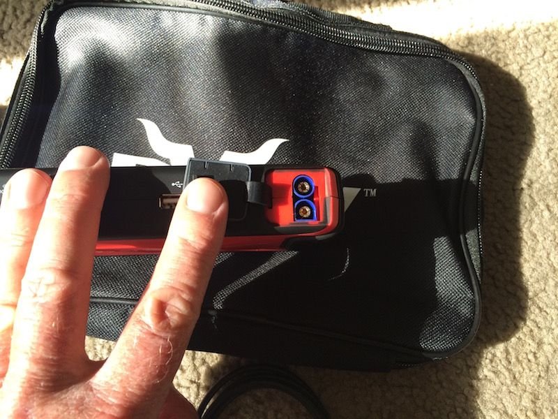

Side view of ports

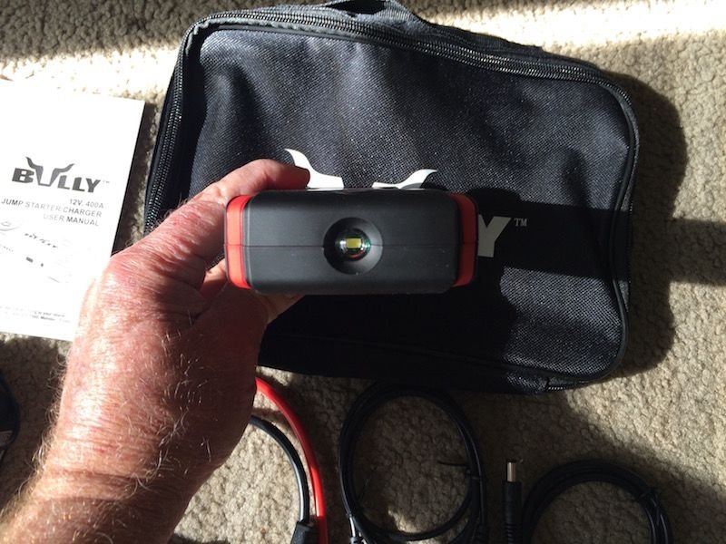

View of built-in lamp
View of high current ports for jump starting
