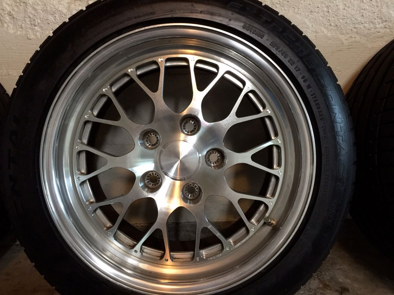

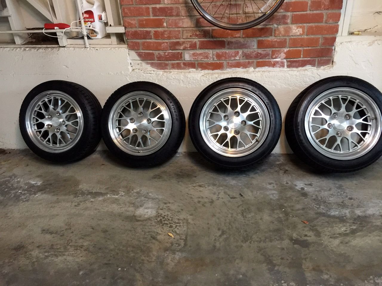

I acquired a set of 17" Fikse FM 10's for sumer wheels for my NB C4. The wheels came with a new set of Continental Contact Extremes, but the tire sizes don't seem to jibe between the fronts and rears...
The wheels are 8" wide in the front, and 10" in the rear. The fronts are running 225x45x17, but the rears are shod with 275x40x17. It seems to me that the rears are too big circumferentially to run in conjunction with the fronts, and that it will wreak havoc on the four wheel drive and possibly the ABS? And if so, is this only a problem on the 4 models, or are these tires simply mismatched altogether? I think the proper size is 255x40x17 in the rear and that I need to ditch the 275's. Can someone please confirm this?
Thanks in advance, and sorry if this question has been asked before...
Fikse FM 10's with new Continental Tires
275x40x17 rears
225x45x17 fronts

Can you post a close-up pic of the rears installed on the car?
17x10 must look great! What offset are they?
