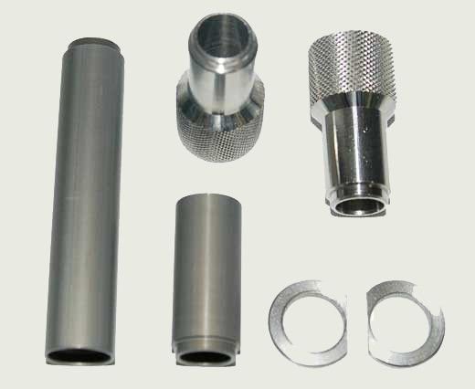

Originally Posted by Wesleyc
I'm afraid of tightening the two nuts too tight and damaging engine to trans studs.
They don't need to be any tighter than hand-tight.
These are knurled and tightened by hand...index finger and thumb. They are made specifically for the engine yoke.

As long as you are using the correct engine yoke (p201) the bolts only need to be snug. The actual yoke supports the weight of the engine not the studs.
My spacers were not as elegant as the ones shown by Alex...
Steve, I didn't have time to stand behind my lathe and chances are I would have needed that socket that was used as a spacer...I bought those from Stromski.

The hex stock (ID a bit larger than the studs' diameter) also works well for spacers. I used the nuts that secured the engine to the trans.
