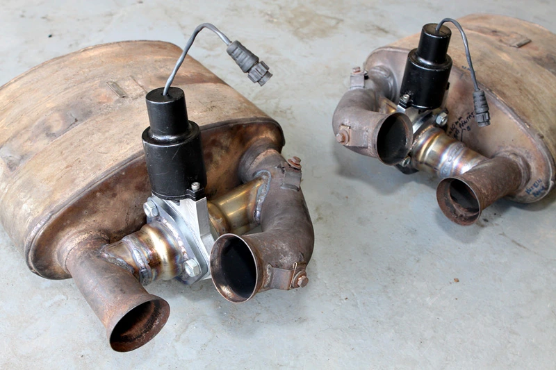

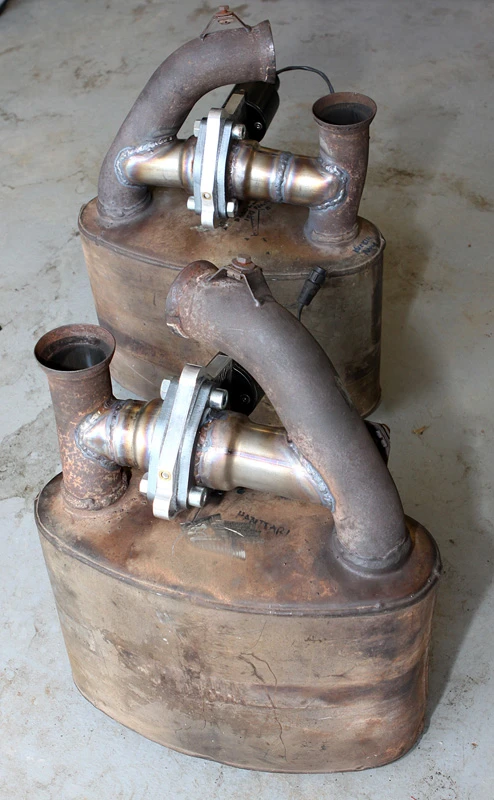

Or you could do this; LPMM behind a push of a button:

Juha, I can´t see your pics.. Just a blue square with a "?" inside..
Really would like to see them.
For all you that not has the possibles to weld it yourselves, buy from Darin!

Right click the little blue square and select "Open link in new window", works fine then. Pretty cool setup, the fab work looks well done. Before my 993 I had a Pontiac G8 GT which is the North American market version of the Holden Commodore VE. It had a 6.0L V8 in it which sounded fantastic with loud exhaust, but finding a system that didn't drone was near impossible.
I had started to fabricate a similar muffler bypass using those electric butterfly valves so I could run through the stock mufflers on long highway trips but still open it up for hooning around. I may add fabricating something similar to the 993 project list.
With my 1 3/4 pipe I don't feel there is enough difference between stock and lpmm to use valves. Valves for cat bypass or completely muffler-less maybe. With my lpmm, most if the sound seems to be directed into the muffler. It is still pretty quiet. Is that 2" and is it really that loud?
