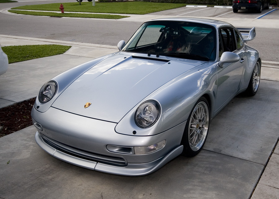

I currently have the M030 suspension set at ROW height, i am wanting to go a little lower, to RS height or just slightly above.
Is this possible to do by keeping my M030 springs and getting the Bilstein HD B6 (with the 30mm extra threads) from carnewal?
here is the ride height i am looking for, wondering if this setup will get me near this, if not ..any suggestions without going coilovers?
thank you for the help

I'm running HDs and M033 with 127 mm front and 114 mm rear ... the springs are not as stiff as the m030 but the same length. I would think you can get RS height. 124 f and 107 r +/- 10.

I have Bilstein HD and Eibach springs, front is about the same height as the car in the picture, my car's rear is a bit higher but I think it can be made as low.
