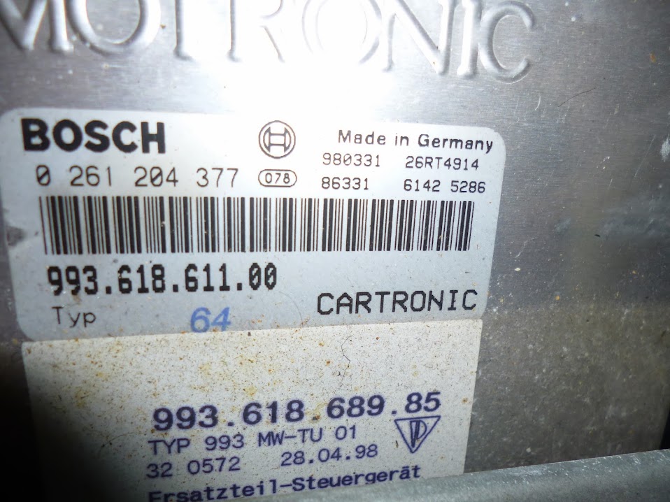

What stand for WLSI ?
I have this DME in my car from factory (or that is what I guess, fitted from factory)

WLS1 is performance kit 1 for 430hp and WLS2 is performance kit 450hp
As per picture, you have a Turbo S dme.
As per TSB, you should install the two oxygen sensors for better engine management

this sounds good. Before buying the car, I did a quick PPI and the OEM Porshce scanner pulled few codes and all were regarding 02 sensors heater, short gorund etc. My car doens't have them, just CAT, so that was like what's wrong? My car, being a euro model, doesn't have the CHECK ENGINE light as well (perhaps French cars are the same back in the 80's and 90's ?) So I don't have CEL in my dash (yes, not burn or remvoed bulb, it doesn't have CHECK ENGINE light).
Well, I'm going to order the missing 02 sensors then as per suggest/TSB.

You have to disconnect battery before, and put the sensors on nearest plugs to engine, not the far ones, there are four holes and plugs.
Your Turbo S DME is OBDII and has the CEL signal, so you HAVE check engine light. At night, put a flashlight at dash oil pressure temp gauge, you will see the CHECK light
Bulb fried or removed, put one.
After re-connecting battery, you have to drive the car a little bit for the readiness codes.
If it is cheap, do an error clearing at the dealer after.
Maybe the factory installed the K24's, and not the previous owner
Go down on your hands and knees in front of front bumper and check inside black grill up, if you have the auxiliary small oil cooler, under driver side headlight.
look at page 1 in this thread, you will see where it mounts.
You realized your car has the 450hp DME, cool no ?
