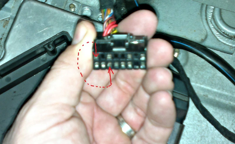

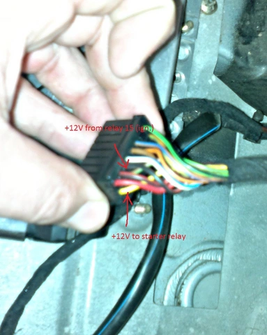

Here's how to semi-permanently by-pass the immobilizer IF you have an aftermarket ECU or your ECU is programmed so that it doesn't need the signal from the immobilzer.
Semi-permanent fix:
Semi-permanent fix:
installed
then the only thing you need is a non OBD2 chip fpor a 55pin ssetup or reprogrammed '97/98 DME
