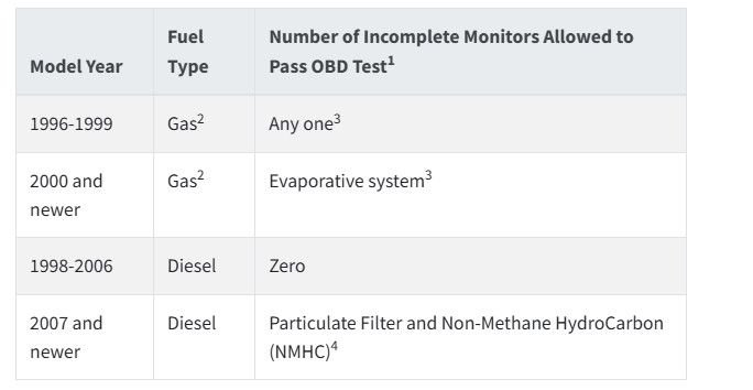

I have the same (permanent) P1411/P0410, SAI codes in my '97, yet legally passed emissions for 6 years with those faults. How? Read about it here. It took some time to develop (and practice) the drive that allowed me to reliably do this (summarized in post #1) , but the principal is simple:
1) Clear your CEL.
2) Drive until you set the minimum # of monitors required by your state (3 everywhere except CA which requires 4) ------ WITHOUT ONE OF THEM BEING THE SAI TEST.
3) Get tested
If the SAI test doesn't complete, it can't trip the CEL and you will pass. That's it.
I practiced the drive referenced in the link dozens of times and found I could reliably set the CAT, HTR and EVAP monitors every single time in my '97. The key is that SAI monitor wasn't allowed to complete.
For '97's this drive can be done in 45 minutes the day of the emissions test and only requires two ~20 minute "normal" drives on the highway, without any special attention to RPMs. gear, etc. I just drove 60-70 mph. If you're in CA, you'll need 4 monitors to complete (any 4), but the principal is the same: clear your CEL, drive until you get 4 monitors to complete without one of them being the SAI test.
My car is now exempt, so don't have to worry about it any more. Hoping this helps others avoid hours under their cars drilling out SAI ports.
