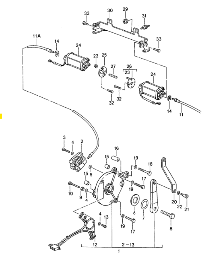

The big round "transmission" (1) that transfers the rotation of the the cable (11A) to the arms of the roof (20) is behind the carpet-covered quarter panel. It's held to the body by bolts (17) and (18) that are notorious for coming loose because (IMO) they are too small for the application and don't have enough thread on the body panel that they screw into.
They are under a lot of stress because the "transmission drum" is constantly experiencing rotation forces from the roof pushing the heads of the bolt back and forth, and the it's on stand-offs (15 & 16) so the weight and stress from the movement of the roof is held away from where the bolts screw in.
I discovered when I took my roof off that one of mine was completely stripped, and it looked like someone had tried to repair it once with a heli-coil. I ended up drilling out a bigger hole in the body and installing a riv-nut (before I got rid of the cab roof altogether). Another cab roof I worked on had a couple of loose bolts there as well, but the threads were not stripped - hence the 2-for-2 making me think it's a common problem.
That's where I'd look if I were you. You definitely don't want them loose - they will wear out the threads. It's VERY easy to remove the carpet covered quarter panels and take a look - it's only a few Philips head screws and unplugging the speaker wire from the speaker.
BTW, don't worry about bolt (10) - it's an adjuster for setting the distance and angle of the drum relative to the body and does not come loose and doesn't need to be touched.
