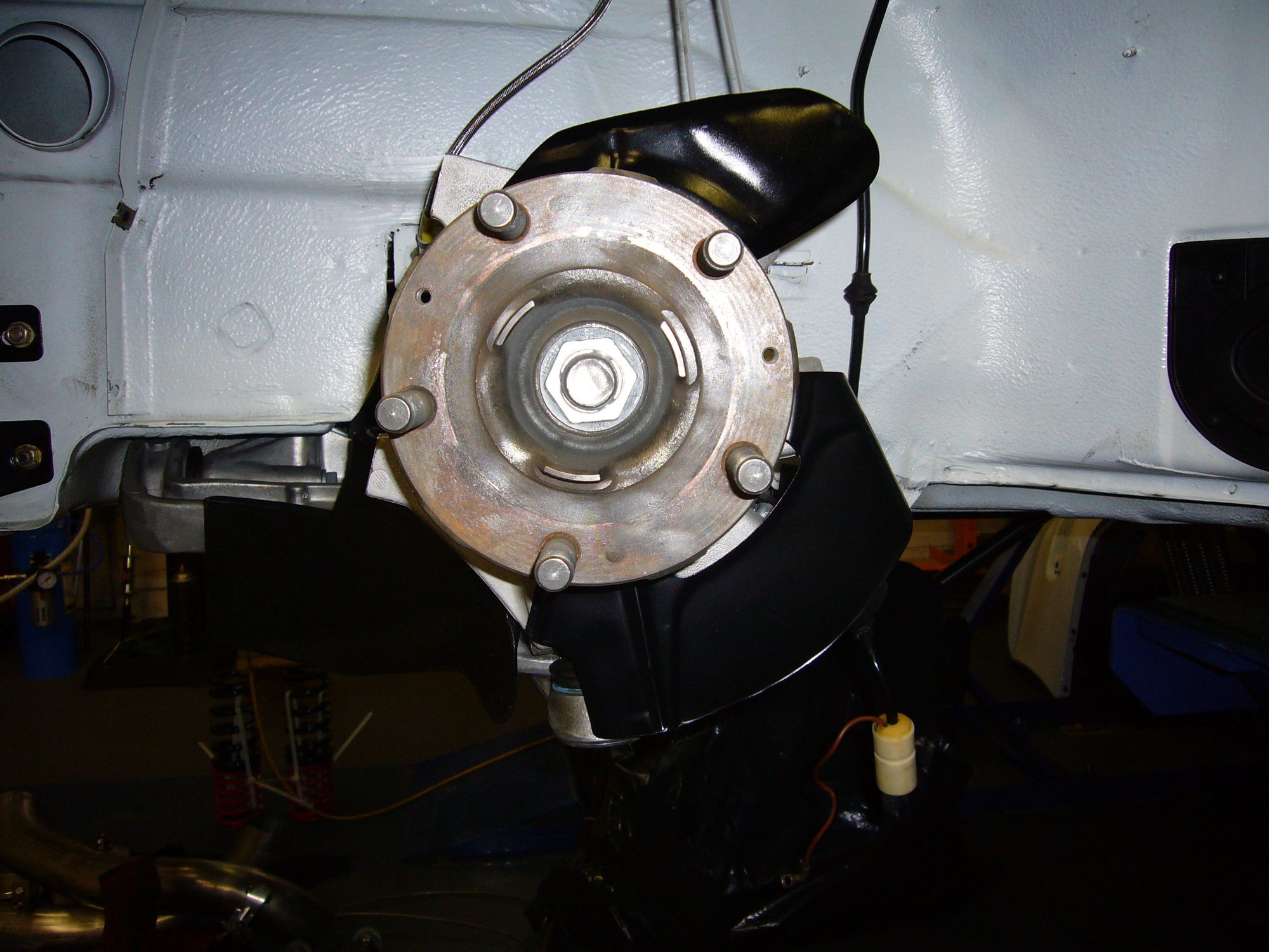

Originally Posted by rwdickerson
Re: When you say uprights you're speaking of the struts? No the uprights = wheel carriers as pictured (RS left & right) in my most recent addition to this string.

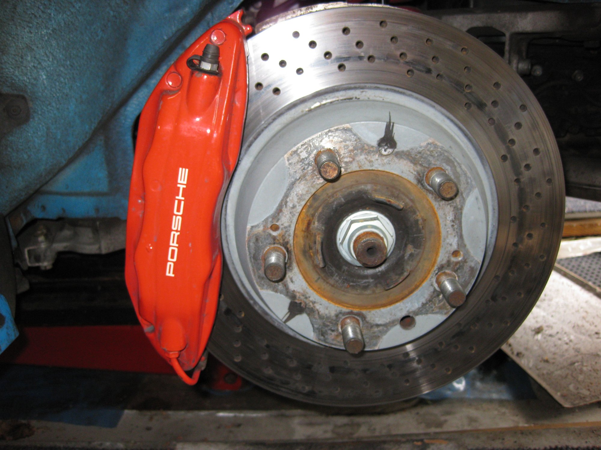

If tracking the car I'd go w/ a 2 piece slotted rotor like Gyrodisk, I know the correct fronts are available and believe that the rears may also be availanow
fronts, the slotted hold up way better than the holey ones in track use, the rear doesn't see anywhere near the abuse as the fronts do so it's way less important there
rears w/ the same hours as the above fronts

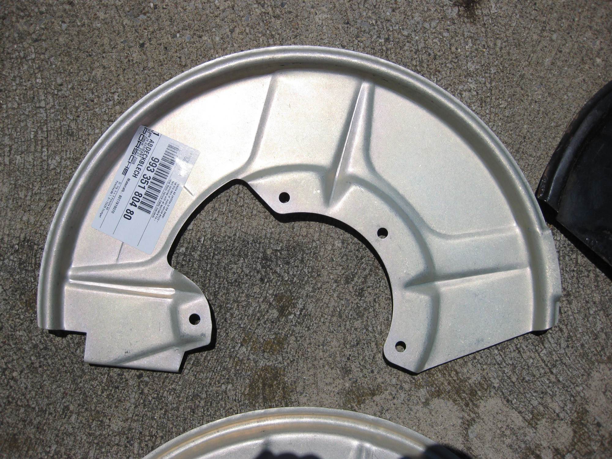

I used the aluminum front RS backing plates
But there are other ways to go here too
Cupcars 964 Cup backing
w/ these the main goal is to shield the electrics(ABS sensors mostly) and rubber components

I've also attached a pic of more icing on the cake for your front suspension and steering during your brake upgrade to wit the Rothsport red poly stiffer steering rack bushings seen in the attached picture (your old ones may disintegrate in your hands when you take them off if they're OE!) and the Tarett Engineering RSR-style inner tie rods shown earlier both items relatively inexpensive in the grand scheme of things! Please note that you're also going to need a lot of small parts per my earlier in the thread (actually Cupcar's) lists.
The attached undercarriage pic is a little disorienting but the front of the car is up. Note the retained vacuum brake assist and BTW, the pictured 5-way adjustable RS front sway bar is a PIA to get in but Cupcar finally had his way with it and I'm still not sure how he did it but we had to take part of the front suspension apart to get the OE M030 bar out and the RS bar in. Note how we've painted (per the factory) every bolt & nut that we set to factory torque specs. Also note the strengthening bar across the leading edge of the steering rack that the factory spec'd for strengthening purposes with 18" wheels (my car came with the M408 option Turbo Technology 18" hollow spokes).

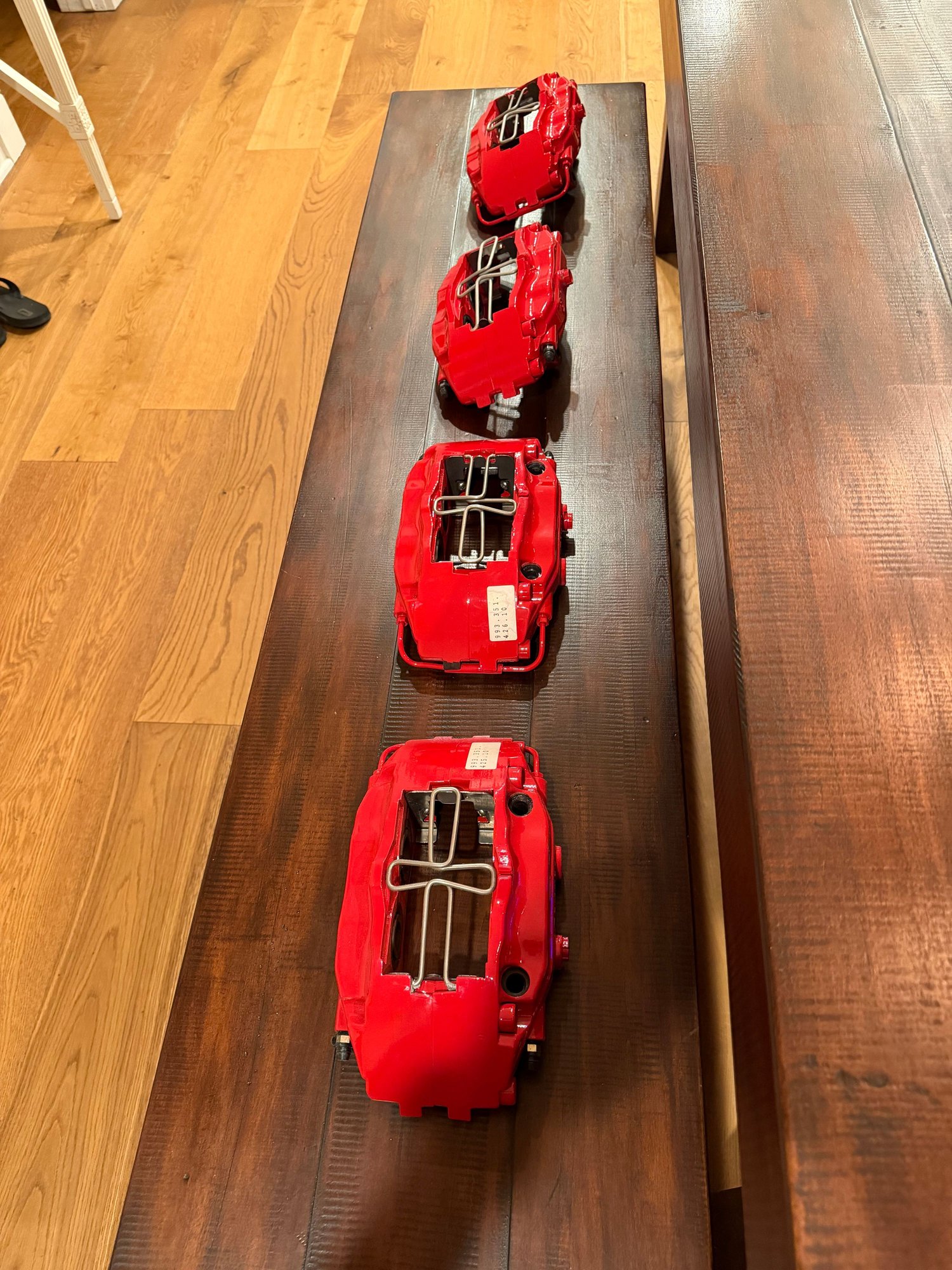

Brake caliper ****. Big Reds and RS calipers.
Brake caliper ****. Big Reds and RS calipers. Parts are coming in.... so excited. Hopefully on the car in about 10 days.
