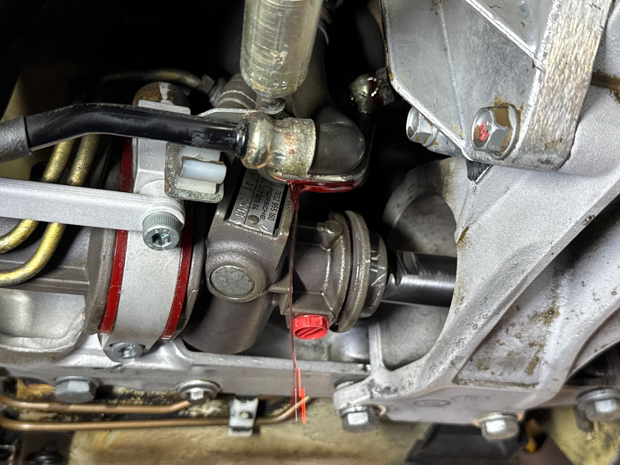

I’m in the process of wrapping up my P/S rack R&R. It has had a consistent slow leak for the past 2 years so finally I removed the rack and sent it for re-seal. It is now all button up but I’m a bit confused as to which fluid to run. My 95 993 is a very early build, 04/1994 to be exact. Pentosin seems to be the favorite on RL, but then most 993s aren’t the early build. The manual states Dex II. Would Dex III (all I could find) work or better to go with Pentosin? Thanks for your input.
