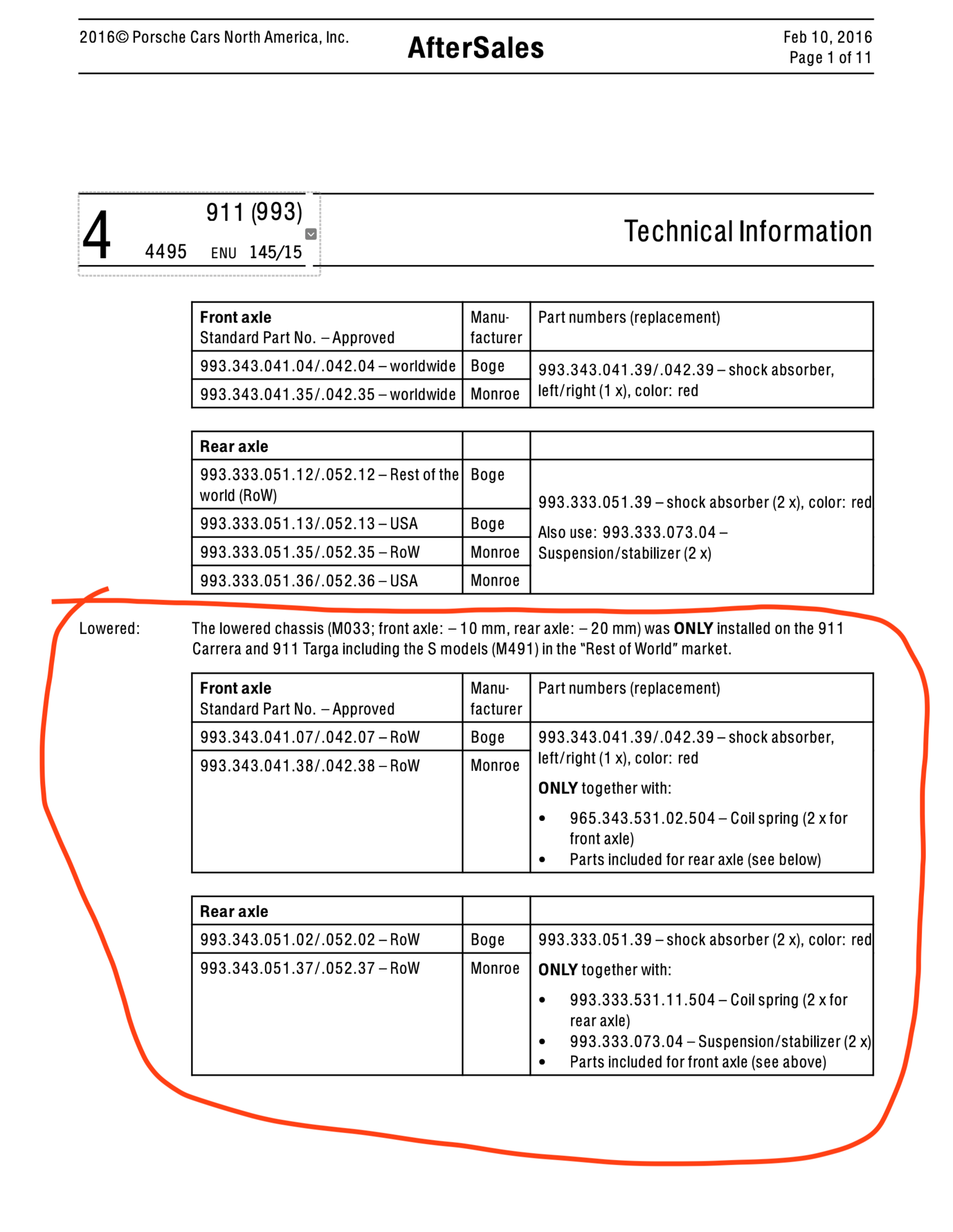

Originally Posted by Floyd540
A very simple and logical suggestion would be to replace the factory (Boge or Monroe shocks which have aged out ) the now available Porsche Classic ones either in green or red (sport). These are made by Bilstein in conjunction Porsche speciffically for your car. I see no reason to wander off into the aftermarket world for products that can be fit to your car but were not developed exactly for it. I have completely redone everything under the car and wenr with the Porsche Classic green shocks. Car is fantastic and just like Porsche wanted it to be like but using the latest Bilstein technology.
Get the real Cheerios, cost more, yes- better- way better
I also used the Porsche Classics on my '98 C2S, only the C2S uses the reds. Yes there are cheaper alternatives, but I only use genuine Porsche parts for other repairs, so why skimp here. I also updated the springs to the ROW M033s, along with new hats. This gives the lower ride height without being too stiff. This car is never tracked, and after a few thousand miles it's proven to be the perfect street setup for me!
