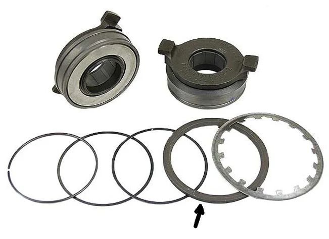

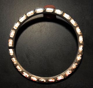

Had the same issue of a creaking noise with a previous 993, a 98 C2S. Same issue of squeaking engine running or not. The squeak was coming from a ring that used as part of the attachment of the throwout bearing. The arrow is pointing to it in the pix. The second pix shows the ring that was worn and shiny (difficult to photograph). The shiny bits match the finger on the pressure plate. Removed the trans and clutch. Replaced the throwout bearing and clutch disk. Noise went away. Hope this helps.
JC 96 TT
