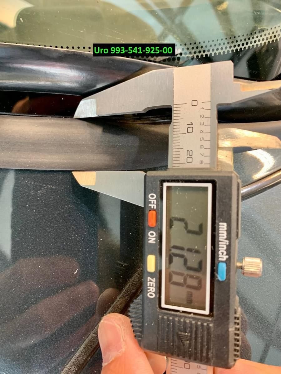

FWIW - I was put on to the URO version of the 993-541-925-00 seal by Einar's Garage in Houston. This is what I discovered when comparing the URO vs. the Porsche seal:

Yep, the extra 1.3-1.5mm comes from the outside edge to the T, but only when smushed flat w my fingers.

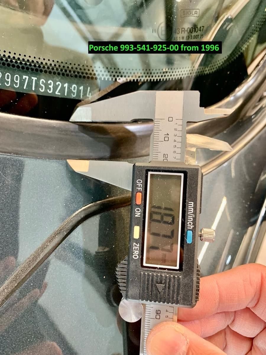

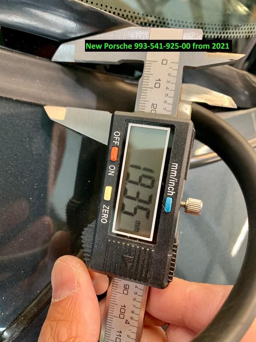

If you need the extra width and are ok with the URO brand, then that is your only option, short of reinstalling the windshield. See pics of width as-installed. The URO is 2mm wider than my 2021 Porsche brand seal …. And 2.5mm wider than my 1996 Porsche brand seal.
