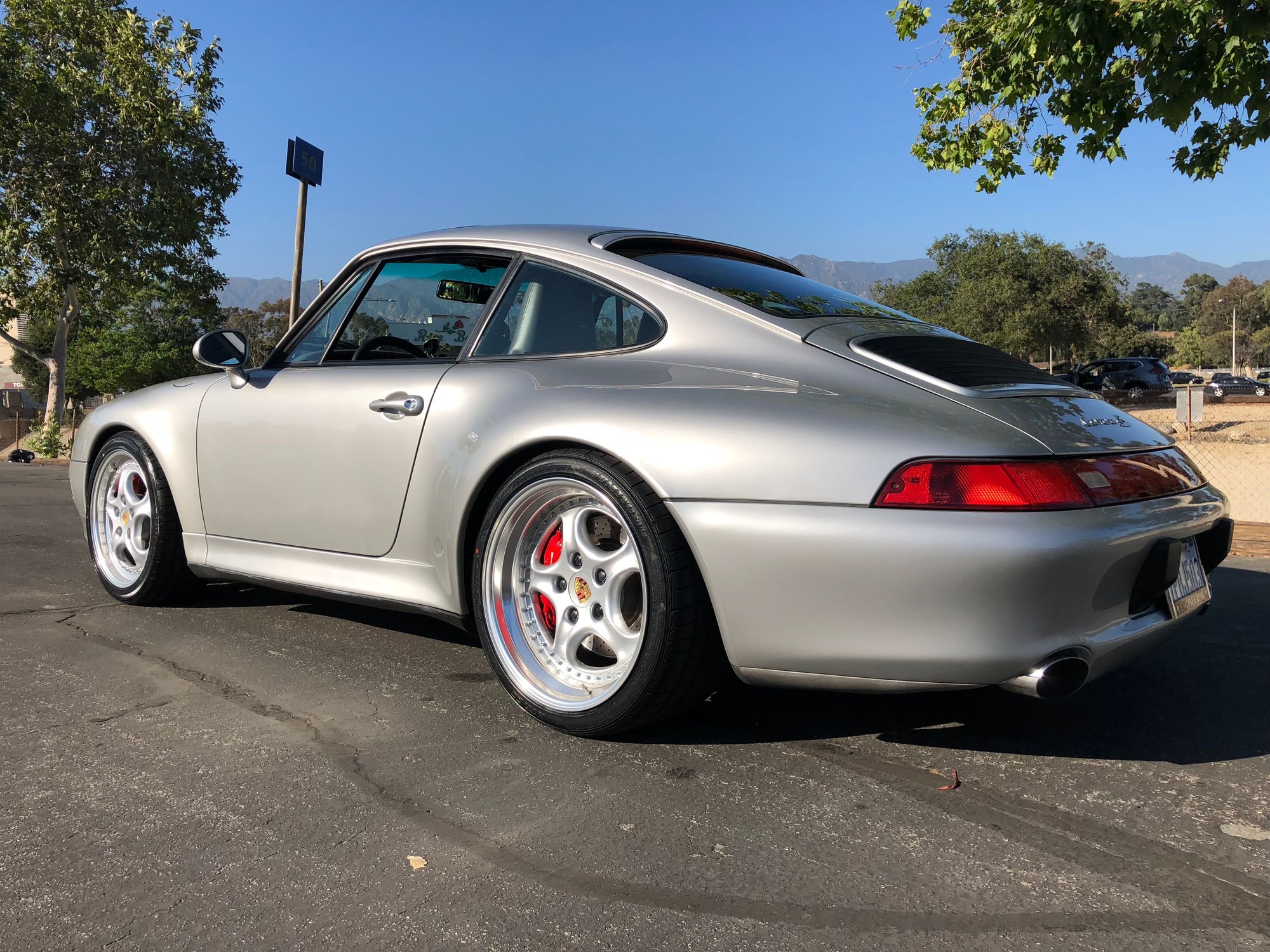

I think they should, but double check the front! For your reference, here is my C4S with 18x8.5 et46 front and 18x11 et40 rear.
thanks for the help! Love your wheels. If you are considering selling, let me know
