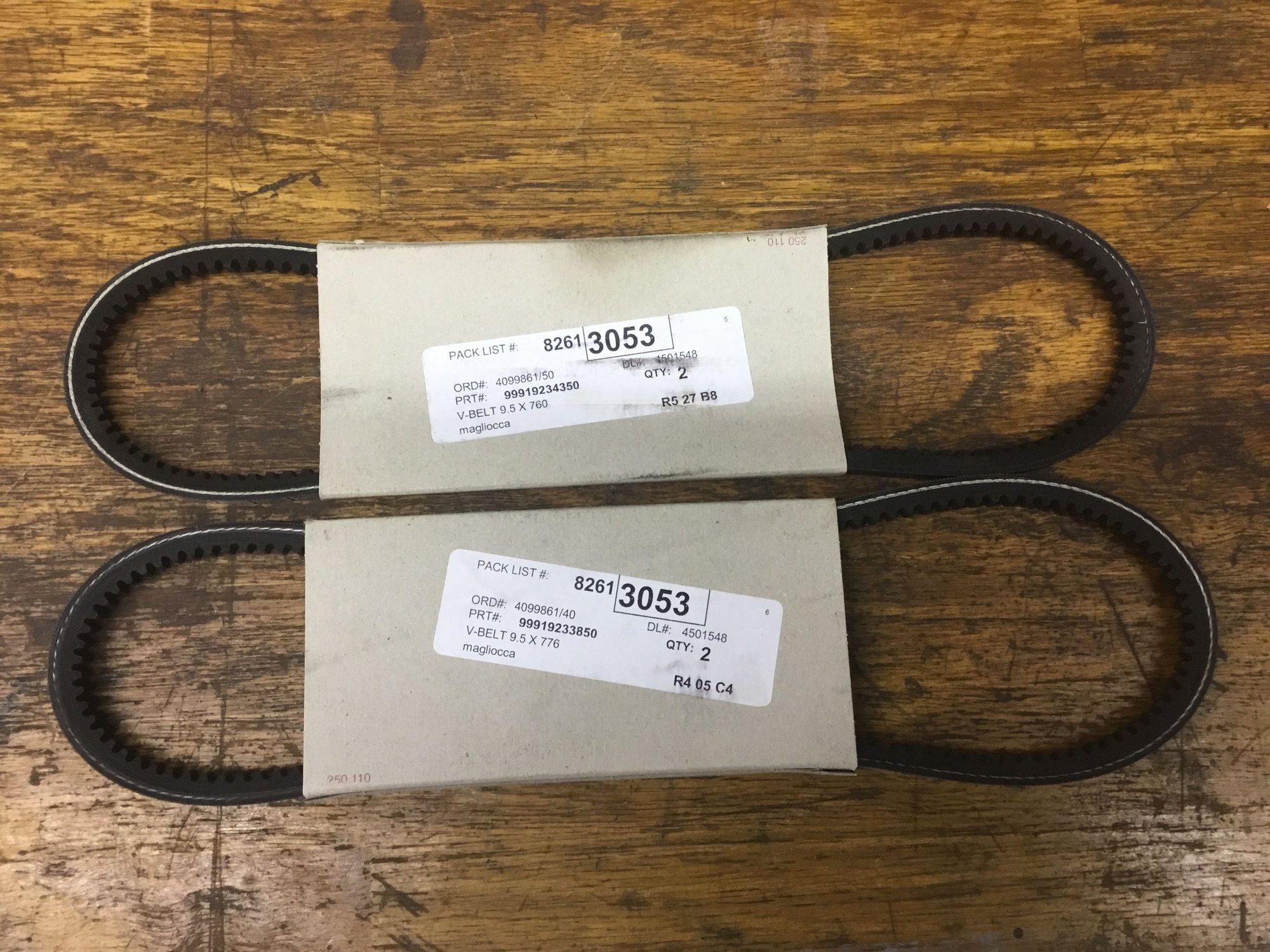

I have these belts, as well as all the other various bits still available. motivated seller.
