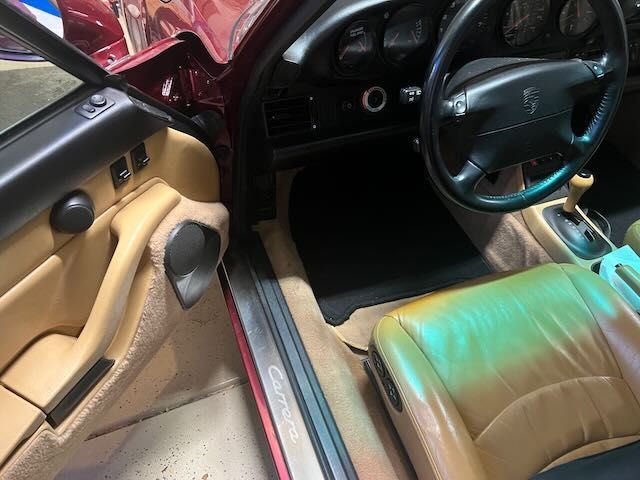

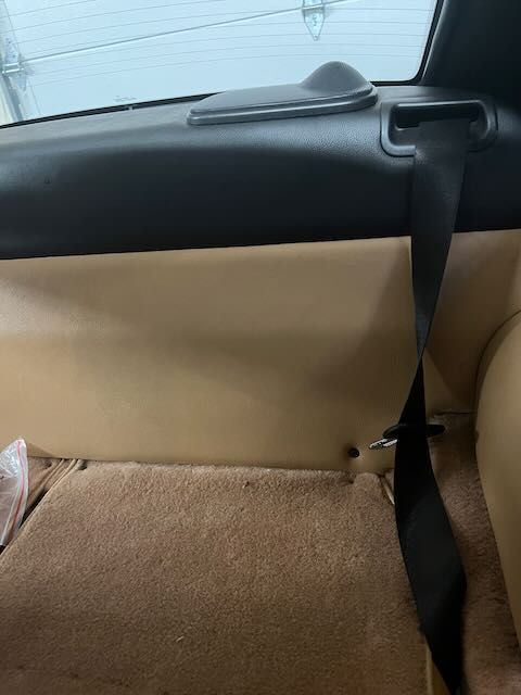

Here are photos of my '96 Cashmere and Black, code LG. Door, console, and side panels are vinyl, front and back seats full leather. I would see if your local "friendly" Porsche dealer's service rep would down load a copy of the Porsche Central Service Report, it will have the codes and brief description. Or get the detailed option code list available from Pervy who is on the 933 forum. Both may have details on which materials were used.
