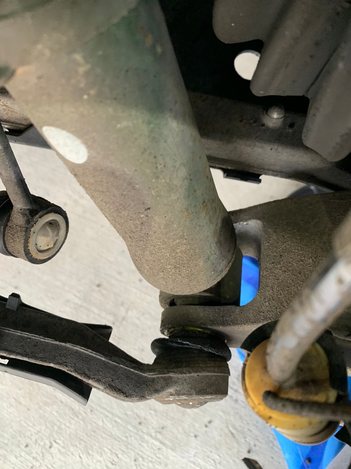

Can someone tell me what this part is with the split boot? I need to replace both sides. Is it difficult just to replace the boot? Thank you. Gunar

toe arm, just buy a new one they take a beating

The boot on those is not replaceable. It's not like most boots which have a spring clip to keep it in place. It is sealed into the arm with a crimp ring.
https://www.delawareporscheparts.com...rm-99333104301

Hi Gunar,
If the boot is split but the joint doesn't exhibit any play potentially just the boot needs to be replaced:
https://www.summitracing.com/search?...ension%20boots
Replacing the boot involves
separating the joint,
cutting off the old boot,
slipping a new one on, and greasing it slightly.
I see BoomBoom's comment above and think one can get a functional grease seal.
The new boot is pressed against the joint by remounting the arm. It shouldn't require a clip to hold it in position over the joint.
Pulling one of the joints and trying a few different sizes of aftermarket boots will probably result in one covering the ball and overlapping some of the external casting body surrounding it providing a reasonably good grease seal. Seeing the cost of the parts it may be worth a little experiment just replacing the seal first

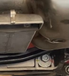

From: Dallas, TX

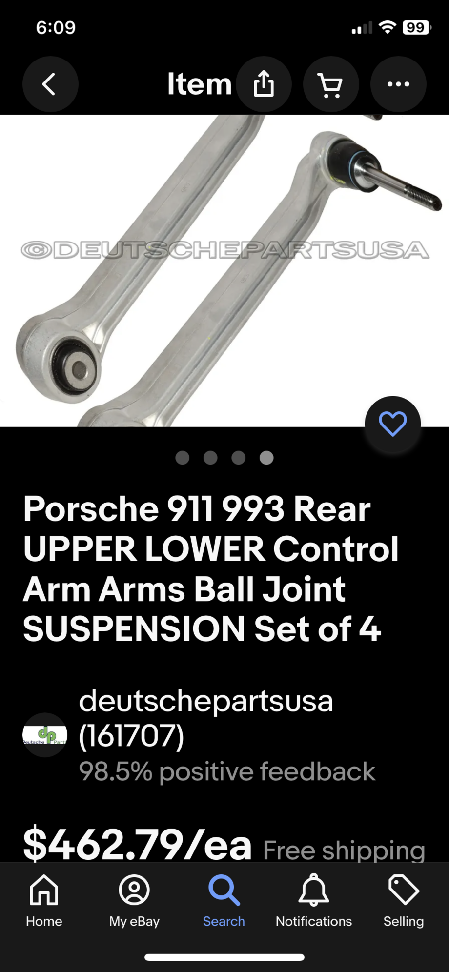

The price seems mighty high. There may be a less expensive aftermarket part from JP Classic:
https://www.jpgroupclassic.com/produ...del=993&page=2

Two of them. I posted the link above for the factory part number. $300/ea.

My one recommendation is to clean and mark your eccentrics with a sharpie on the inner bolt before loosening to keep alignment. I like to use (3) lines vs in to increase accuracy.
The left side inner bolt is sometimes hard to remove as it hits the heat exchanger. Suggest putting a jack under the engine and taking the weight off the motor mounts which is usually just enough to wiggle the bolt out.
