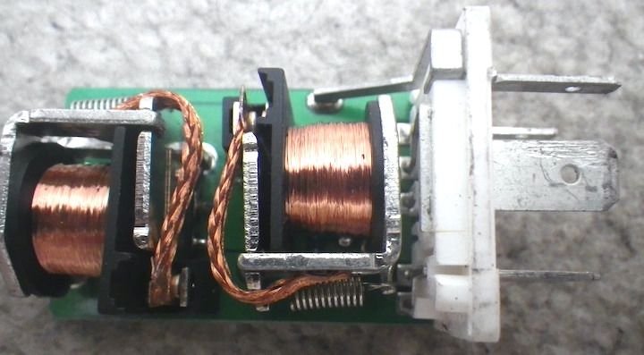

I took the relay apart and found what appeared to be a suspect solder failure. Resoldered it and took a short then long (1hr ) test drive. No issues since the fix. Hoping I got it but ordering a spare to have on hand.
wesr your experience sounds similar to mine. Thx.

Yes, it can get quite warm as the internal relays are in the actuated state with the engine running and their electromagnet coils produce heat. This is part of why it fails as temperature cycling and vibration eventually cause one of the solder joints to fail.
Andy

When my first one failed it was the solder joint to the internal frame that holds the relays. When I resoldered it I added a few copper strands of wire to the joint. My thinking is that it adds strength.
In any event, I have only had one DME relay failure event in the 100K+ miles on my car so I can't see the benefit of paying a premium for the solid state version especially since my original, now fixed, sits in a door pocket at the ready.
There is an upside to buying the one made in Europe you mention in that it probably is the same design as the one being replaced. Purchasing one made in Asia most likely doesn't share the same design and may have a shorter service life.
Andy

Guessing? The OEM part doesn't get any simpler, i.e. just two relays;
Originally Posted by 71-3.0-911
How many times are we seeing stock failures? Regularly.
But let's stick with the original since it's super reliable.
Agreed, the OEM relay just needs to be re-soldered. It's having been 2X the size (more susceptible to vibrations) of other relays in the fuse box contributes to its solder failures,
besides a marginal original soldering process. Given the thermal mass of the relays used, a reliable soldering process requires properly heated relay pins before the solder application.
Many 964/993 owners always carry a spare relay.
