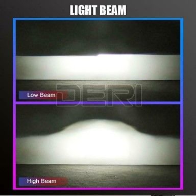

Some of the LED projectors come with a single high beam but many of them come with Bi-LED's for use as both high and low beams. It probably makes sense just to do away with disable stock H1 low beam altogether and use the LED's for both beams. It reduces complexity and cost and increases performance significantly. The Bi-LED projectors contain a simple small electric motor which switches the configuration back and forth. Picture below of how one projects. Absolutely perfect low beam cut-off which is so important to avoid blinding on-coming drivers. More later.
Thanks for the input provided via PM's!
