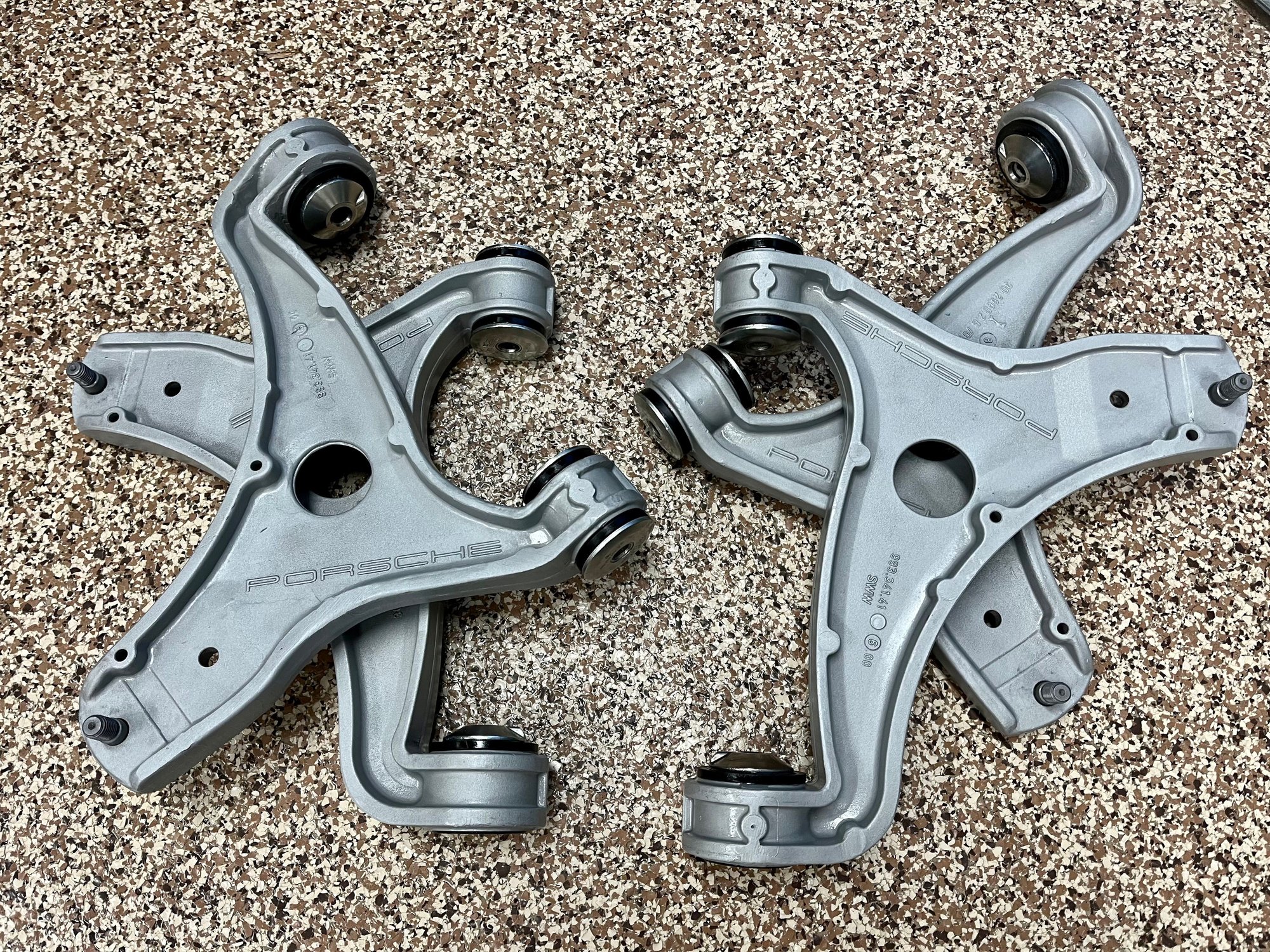

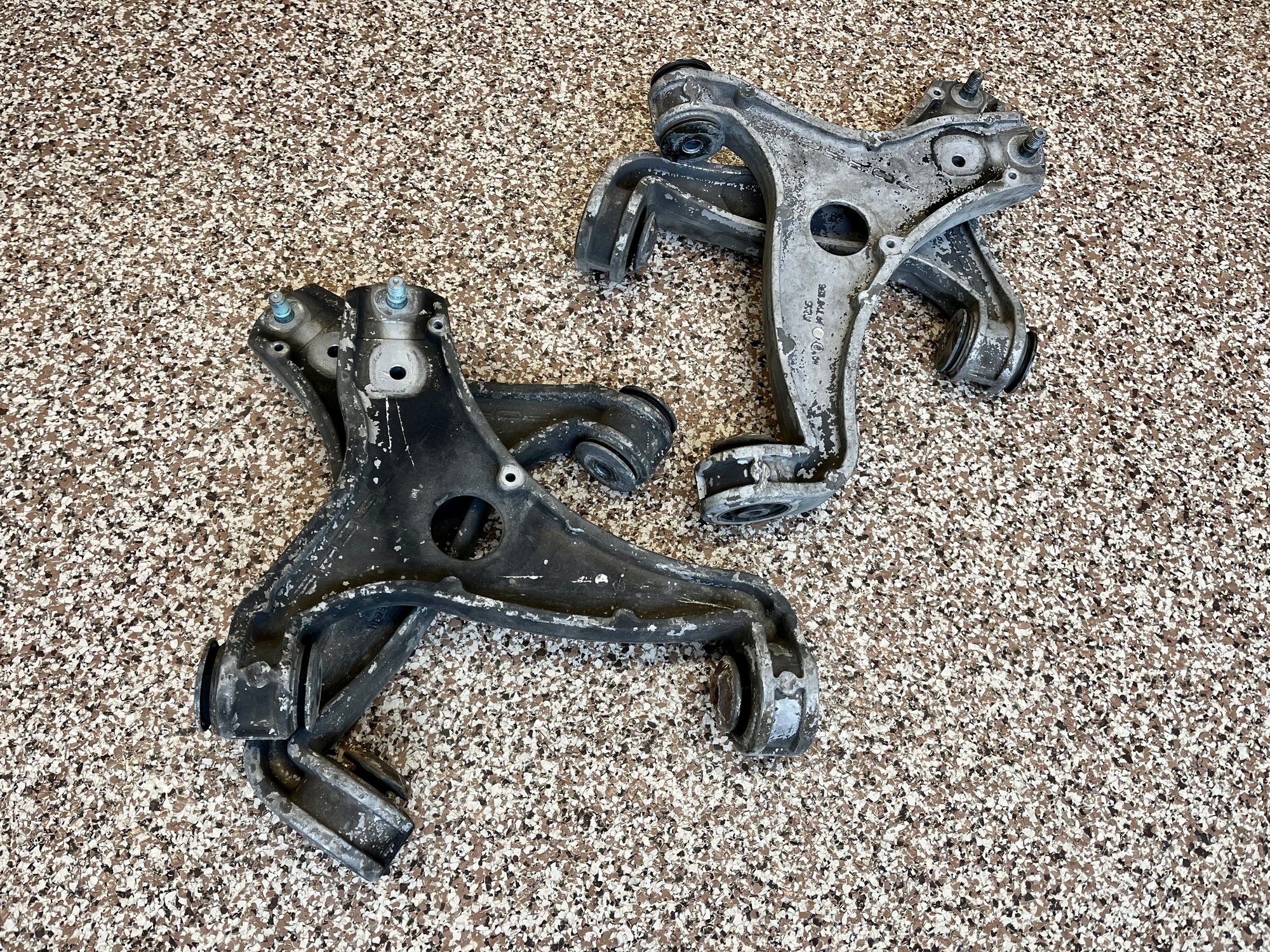

If you lived in the US, I could rebuild your control arms, or send a rebuilt set for exchange. I've rebuilt between 80 - 90 sets of 993/964 arms for Rennlisters over the last 10+ years...
But shipping to Canada would probably be prohibitively expensive.
