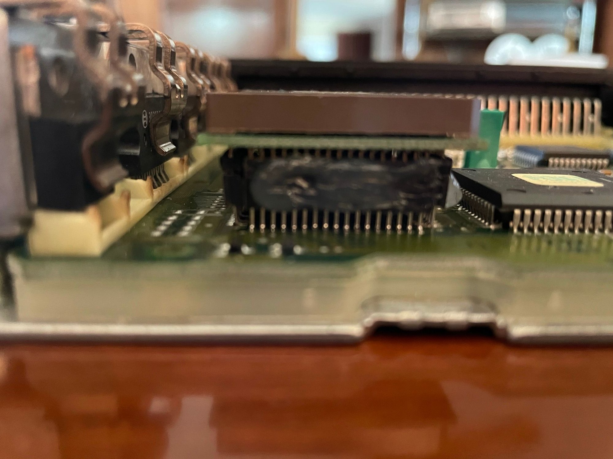

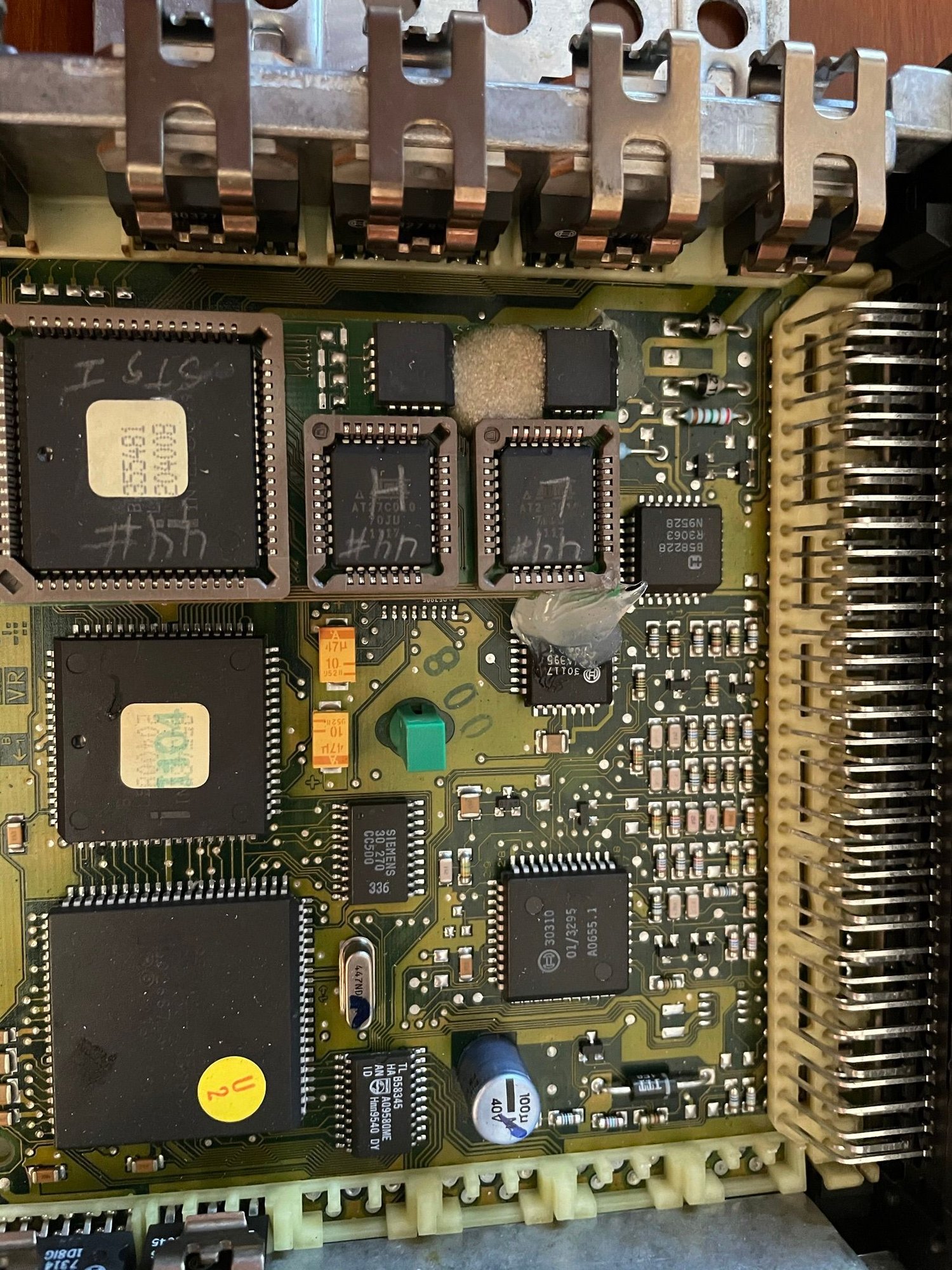

It would seem that Todd from Protomotive figured a way to chip a MY96 ECU. I am no longer using this from my old engine with protomotive turbo setup. I am not sure what the additional chips are for maybe someone can chime in.

Back in the day they used a piggyback controller to emulate a new chip, most likely that is what was done for the '96, I truly hope that ECU Docs can do this but doubt it very much, do keep use posted should you go that route, as I said they were a pleasure to deal w/ when one of my DMEs suffered cold solder failures

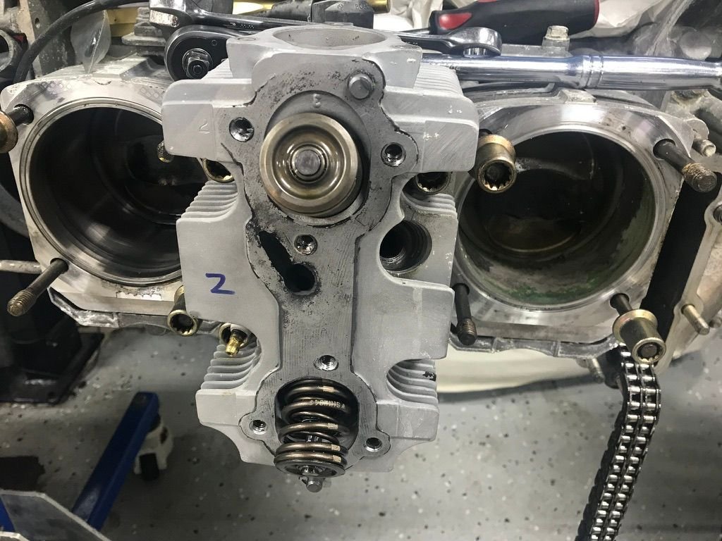

I opened a 95 993 engine not long ago and it had 9mm valve stems with 49/42.5 openings and not the 8mm's I am used to seeing on the later engines. Someone was in this engine before I must assume they switched to 9mm valves for heat dissipation. It is the only 95 I have opened so I made an assumption on valve stem size.
Hard to tell from the picture but these were 9mm.

If it's an oe 993 head there are 2 things t easily look for
1) RR350 is the alloy used, the only other heads made of this alloy are 930, the alloy designation can be seen here , top left
2) the exhaust has 4 possible std locations
The head in you pic is a US version w/ SAI provision
a RoW head looks like this, no SAI
These are 964 heads, exhaust has only the 2 studs as seen on all previous 911s

So I must assume someone decided to replace the valves and guides with 9mm vs 8mm for some reason.
