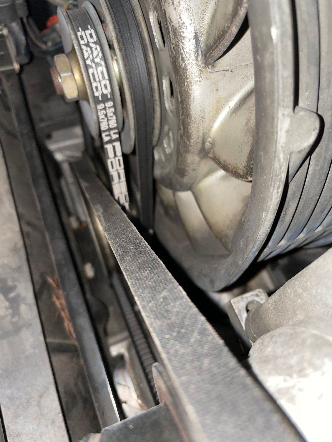

Is there any of this film on the crankshaft pulley, or in that area? Is the film oily?
If you shine a strong flashlight down into the tin below the crankshaft pulley, does it look wet?
How about the cam chain cases on the rear of the engine, any wetness, dripping or seepage from them?

Originally Posted by rocket94
And the spoiler wall?
In your photo above, either the inner belt has not been replaced, or the roller is pressing far too hard - look at the indentation on the belt. If the roller is jammed, you'd expect a burning smell, but if it is digging into the inner belt then that may explain the 'soot'.
I did check that idler Pulley and it spins fine. I’d say that belt hasn’t been replace.
Now that i researched the spoiler wall i will go check that out
No Oil and all clean, well Dry.
