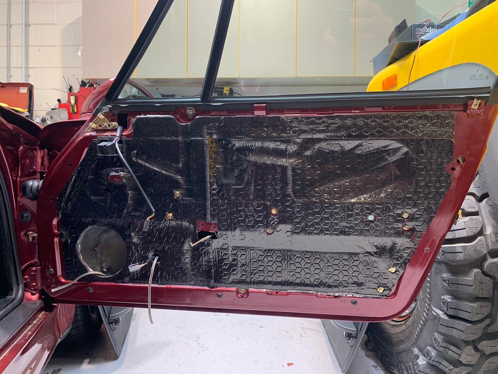

My sound insulation is new (from May). It’s also the main reason I’m dreading taking everything apart because I’m certain I won’t be able to do as good of a job as the guy who did the doors for me:

Wow that’s some sound deadening job. So much for my theory. Why not take the car back to this shop and see what he can find?

Somehow I think the rattle may be the result of the major aftermarket intervention on the door where insulation was added and the entire wiring harness was disturbed.

I doubt it is the deadening. The noise only started after one **** workshop adjusted the hinges (half a year after the deadening), which is why I assumed it was the hinges/door catch initially. I assume with all his banging around he loosened or broke something.

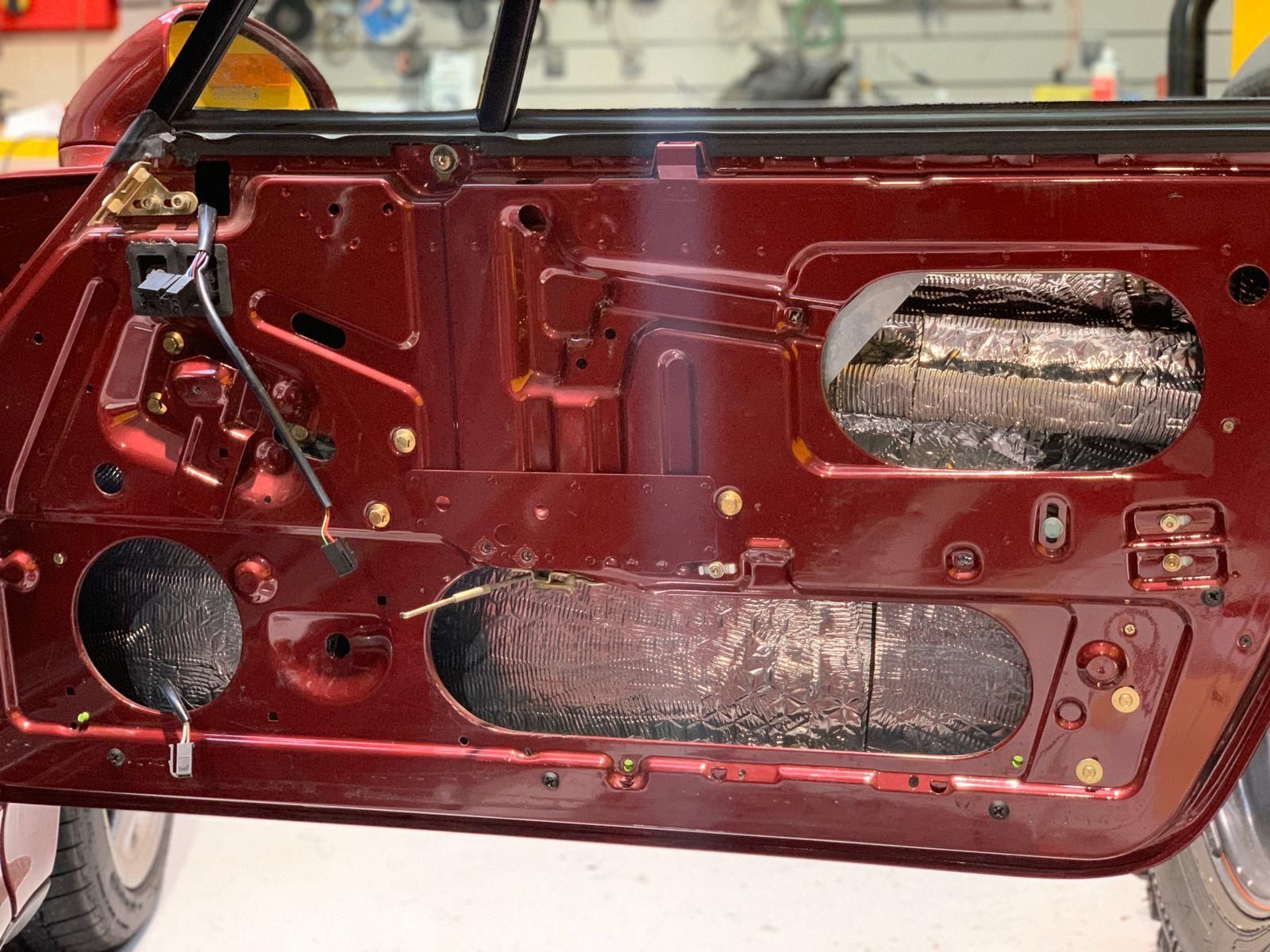

anyway, with regards to adjustments, does anyone know specifically what each bolt below is responsible for ? I have labelled them for convenience:
