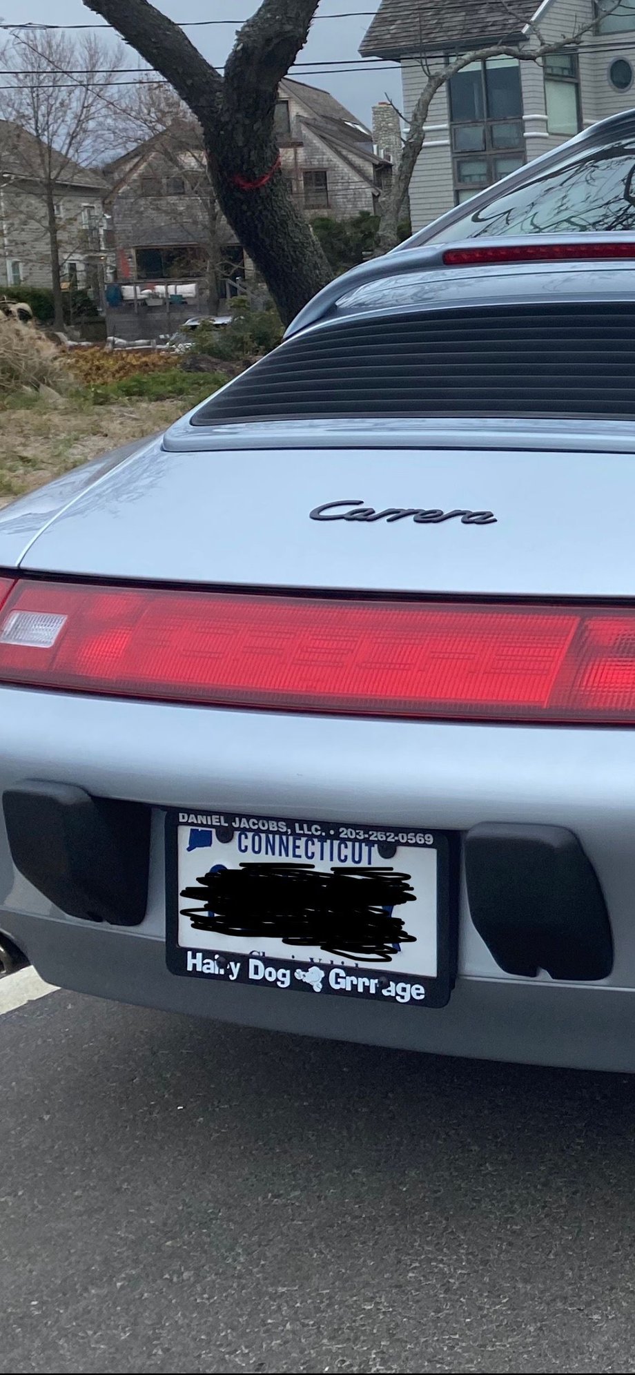

Dan and his son Baron do all the work on my '95. You won't find a more capable air cooled mechanic than Dan. He knows these cars inside and out. Definitely give them a call. We are very lucky to have them in our area.
