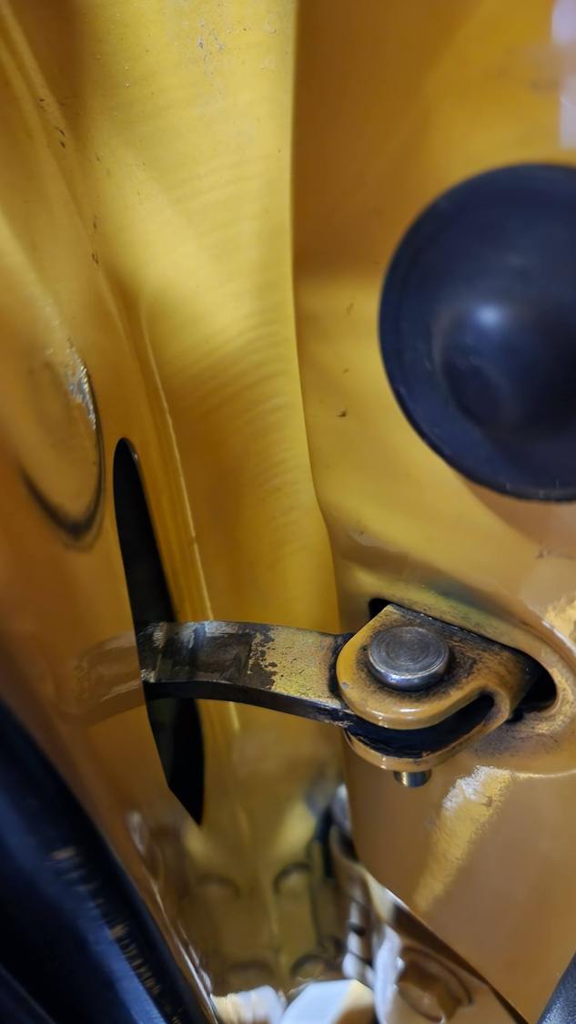

Here what mine looks like...
Patina.

Originally Posted by AOW162435
Patina.
Andreas
Just another rite of passage in the 993 world
