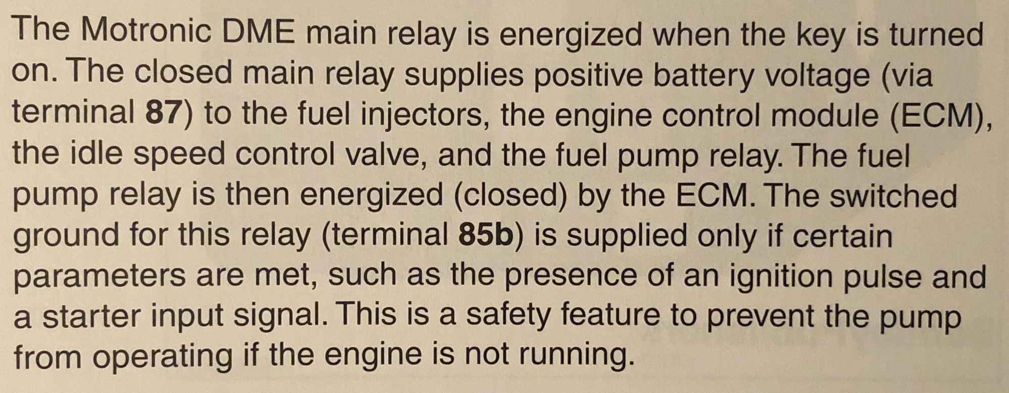

Some further clarification on exactly how the original DME relay works. The fuel pump relay is incorporated into the DME relay. The engine has to be cranking at minimum 30 RPM before the fuel pump will energize, so no pre-prime, nor do I find it possible to hear when the pump starts using an original relay. This is from the Bentley shop manual:
