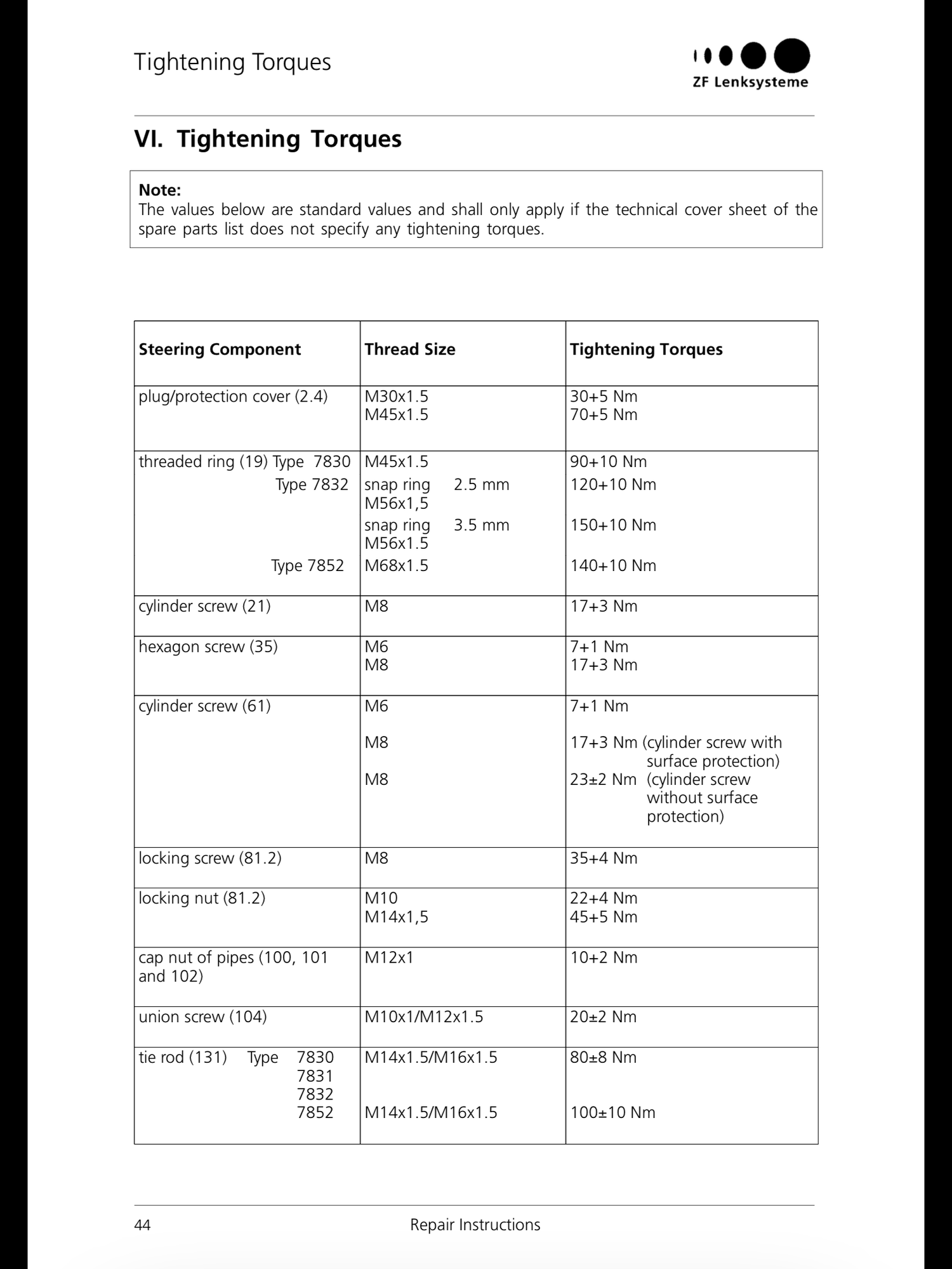

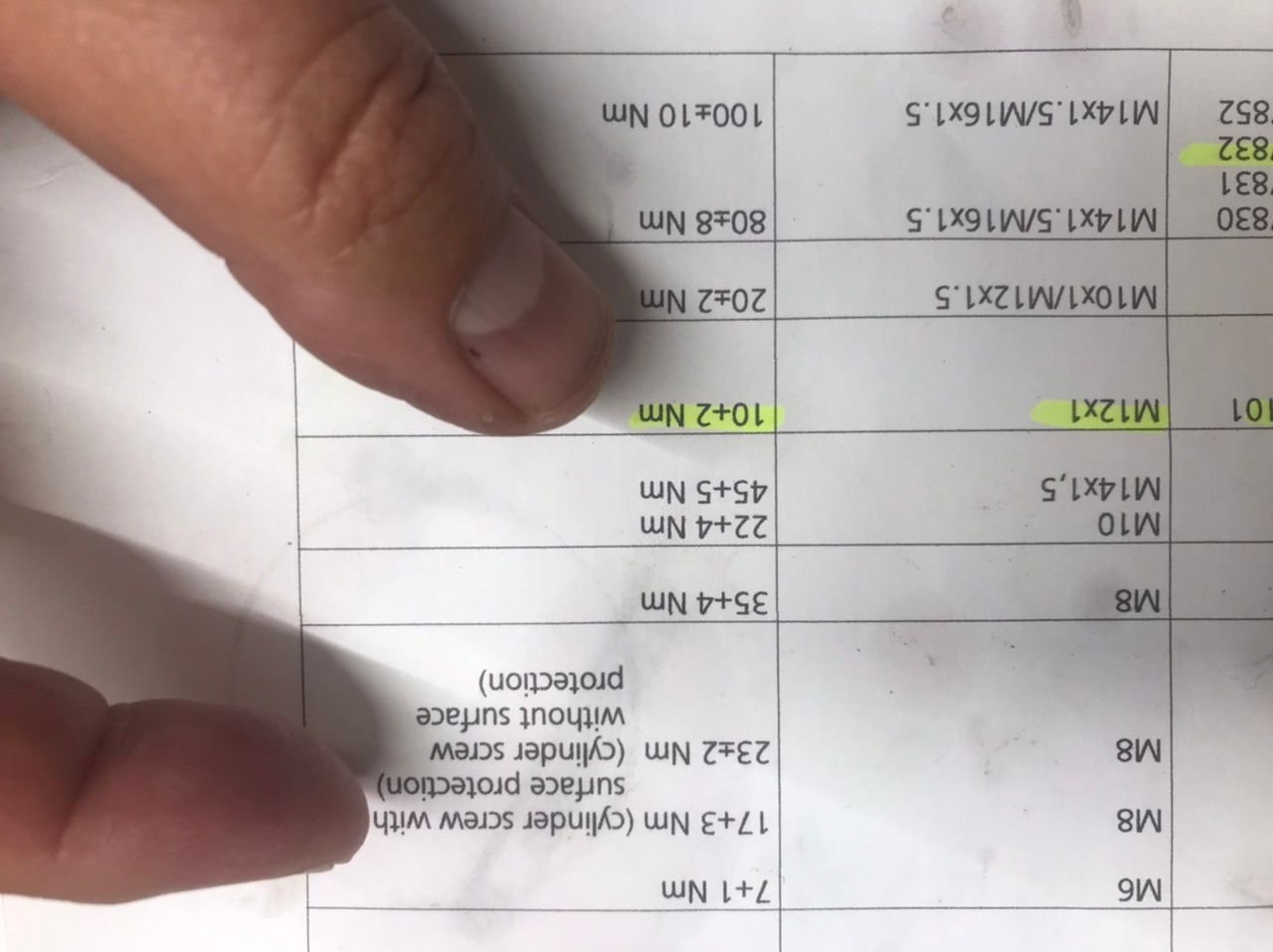

What does it signify if a torque value looks like this: 10+2 ?
not 10 +/- 2, or 10+2 degrees (unless it shorthand for the latter, but i doubt an angle gauge would make sense in this application).
Does it mean tighten to 10 Nm, then add 2 more (for total 12), and re-tighten?
or ????
Apologies if this appears upside down... iOS hates me

We need to see more of the page for context.

here you go Andy

Seeing that torque wrenches typically have accuracy in the 4% range I believe the value is stated as the indicated value or greater by the + value variance/tolerance shown. Under torquing is not allowed.
Let's see what others come back with for answers.

Simply a tolerance.
Some of the values on your sheet have a +/-. Anything with just a + means only a positive tolerance.
