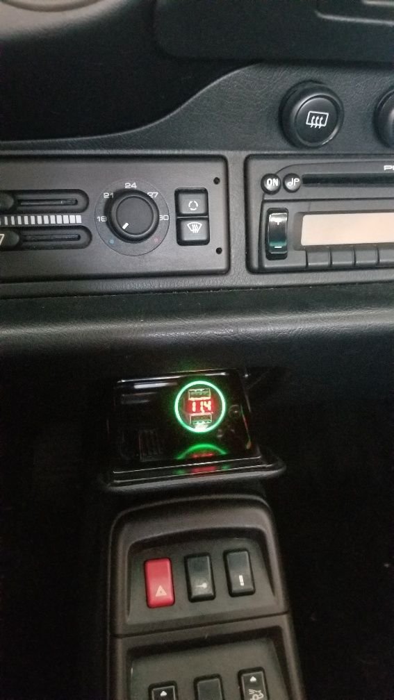

Must be something in the air! One of my projects today was prototyping this set up. Still needs fitting but I think I'm going to like it. I'm sure some will say if you have a voltage gauge you should watch it all the time, but I think the trade off with not having the distracting LED's visible all the time (especially at night) is worth it, Will update with the final install. Oh, and before I get any helpful hints, that's not my actual car battery voltage. It's hooked up to an old key fob battery for testing. Here's info on the unit.
https://www.amazon.com/dp/B0773BYS6P/ref=sspa_dk_detail_1?psc=1&pd_rd_i=B0773BYS6P&pd_rd_w=hAlZu&pf_rd_p=48d372c1-f7e1-4b8b-9d02-4bd86f5158c5&pd_rd_wg=8IZ6I&pf_rd_r=GYD30PXJ97B3SZGDW3CQ&pd_rd_r=9423b214-91e5-43b9-8a07-6b3a8e958231&spLa=ZW5jcnlwdGVkUXVhbGlmaWVyPUEzU0I1OFVJMUQ2WlBPJmVuY3J5cHRlZElkPUEwMzExMTk4Mk8zR1VTTUY2QjBYTSZlbmNyeXB0ZWRBZElkPUEwNTcwMTMzMTdTRTM1WVVDN09MMSZ3aWRnZXROYW1lPXNwX2RldGFpbCZhY3Rpb249Y2xpY2tSZWRpcmVjdCZkb05vdExvZ0NsaWNrPXRydWU= https://www.amazon.com/dp/B0773BYS6P/ref=sspa_dk_detail_1?psc=1&pd_rd_i=B0773BYS6P&pd_rd_w=hAlZu&pf_rd_p=48d372c1-f7e1-4b8b-9d02-4bd86f5158c5&pd_rd_wg=8IZ6I&pf_rd_r=GYD30PXJ97B3SZGDW3CQ&pd_rd_r=9423b214-91e5-43b9-8a07-6b3a8e958231&spLa=ZW5jcnlwdGVkUXVhbGlmaWVyPUEzU0I1OFVJMUQ2WlBPJmVuY3J5cHRlZElkPUEwMzExMTk4Mk8zR1VTTUY2QjBYTSZlbmNyeXB0ZWRBZElkPUEwNTcwMTMzMTdTRTM1WVVDN09MMSZ3aWRnZXROYW1lPXNwX2RldGFpbCZhY3Rpb249Y2xpY2tSZWRpcmVjdCZkb05vdExvZ0NsaWNrPXRydWU=
Pretty cool that the green ring starts flashing below 11.5v.
Ron

Yes - I Iike your solution as well because you now have an auxiliary socket of the "right" size. But as you said it's a personal taste thing. And I like the fact that this will be reversible.
I forgot to make it clear - I'm not trying to add a new socket in the tray to stick this thing into - would never fit. I'm actually planning on gutting this unit and wiring and mounting the display on the right side of the tray opening. We'll see how it goes.
