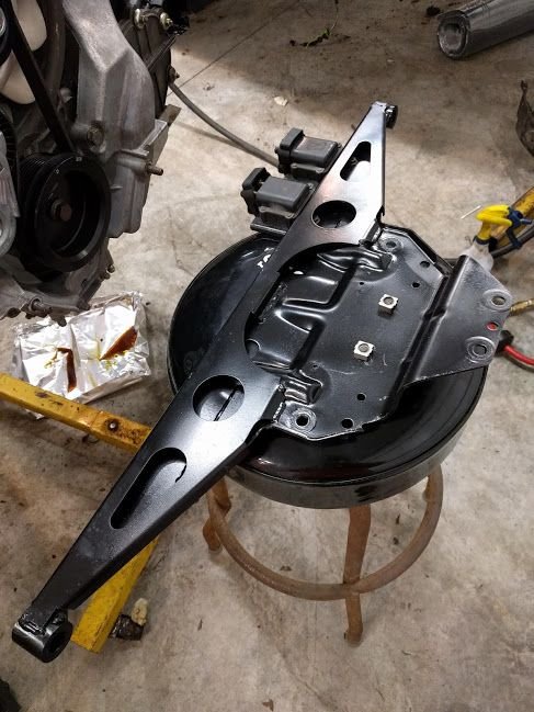

Originally Posted by samurai_k
http://www.jackals-forge.com/lotus/9.../rscarrier.htm
Mine failed so upgraded it via a retrofit of a reinforcement similar to the one above via Rothsport
https://www.rothsport.com/Products/E...ne-Carrier.htm
Rennline also makes a retrofit kit as well.
Not to say it happens to everyone, but here is a failure of the stock carrier... My car has a modified engine and had some track days early in its life. Rothsport repair and reinforcement looks like below which is similar to the rennline one suggested above.
Both Rennline and Rothsport will re powder coat the carrier to make it look nice again as well which is an added bonus to their shop service to weld the reinforcement on.
Anyways...back to your original question as we have digressed here a bit. The RS motor mounts will install with the stock carrier with no problems. Often the problem is getting the stock motor mount to come off if the nut is seized on the motor mount stud or the motor mount stud frees itself since the motor mount failed.
Depending on your driving style or upgrades in your car, you may want to consider one of the upgraded carriers as discussed above.
Cheers!
