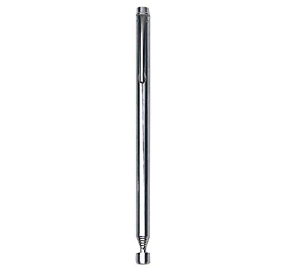

I use a small telescopic magnet doohickey. Turn the tip 90*. No problema!

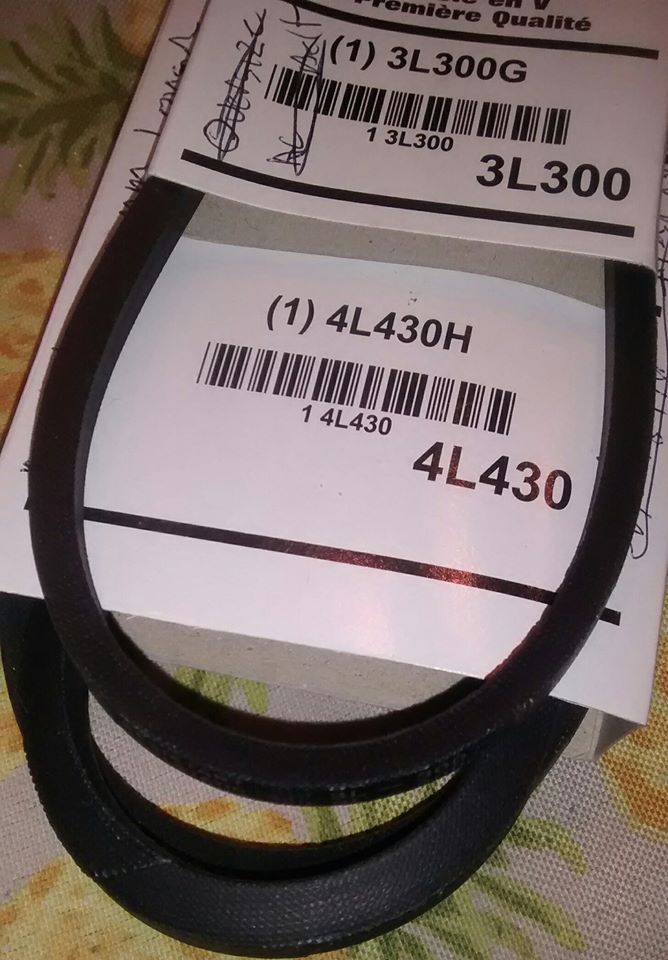

I went ahead and purchased some Dayton industrial V-belts from Granger Industrial Supply thinking they are a more durable option to the toothed V-belts used on our cars..They have more layers of reinforcement., more like the original belts when ordered from Porsche years ago. I looked up the reason for the toothed profile. It causes the belt to run cooler when used on smaller diameter pulleys. Not sure it is an issue in our car's application. The longer 4L profile AC belt was ordered about 10cm longer than the original belt. I ordered it to see if it can be installed without unmounting the compressor.

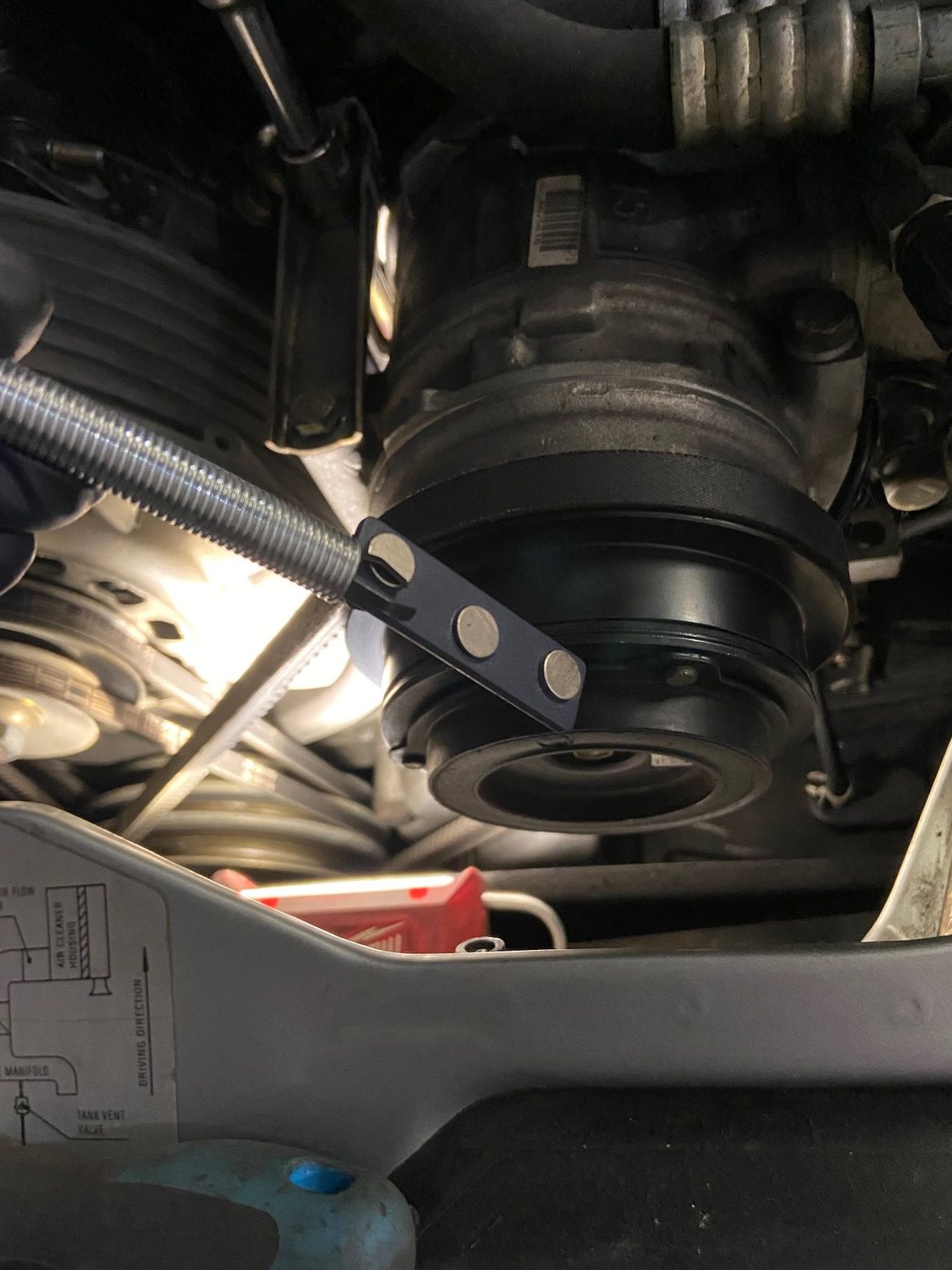

Changing spark plug wires and had to remove the compressor bolts and support bar on left side - my solution for the PITA square nut re-install:
(The plastic strip w/ the small magnets is from a badge from a long forgotten work conference name tag.)

07C4S,
Brilliant! And many Porsche owners have just such a magnetic strip already at hand, on the back of their PCA name badge!

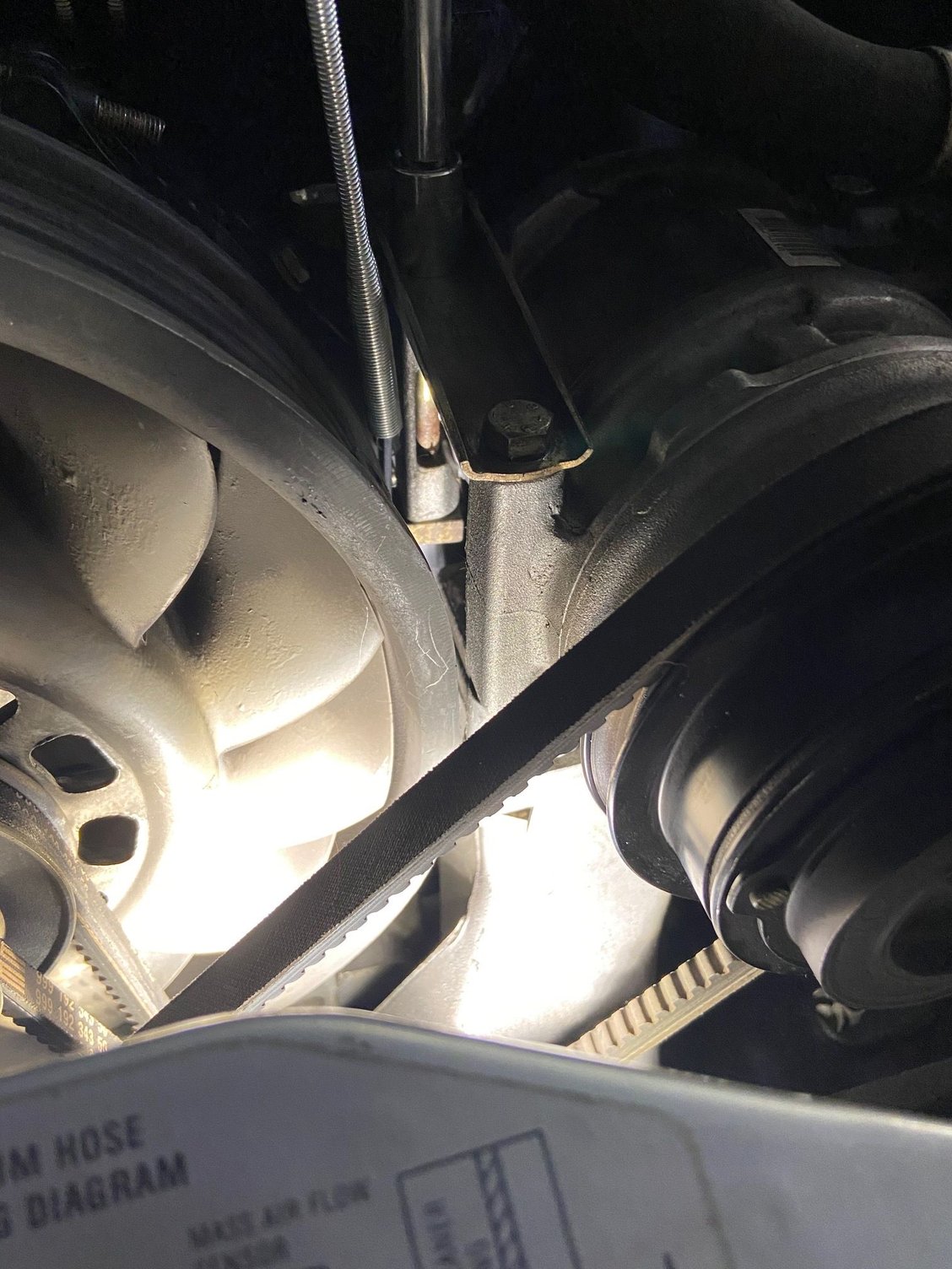

I just changed my belts last week. Following DIY instructions and tips found here and elsewhere. My hands were able to get under the compressor to hold the square nuts so no issue there.
That said with the pesky bolt in the above pic, the one at the top left of the compressor, I actually did not remove the bolt (and therefore the nut). I just loosened it enough that it became a pivot point (with the other 3 bolts removed) by which I could rotate the compressor to loosen the belt enough to remove it and reinstall the new one. This surely saved me a lot of potential grief with that bolt and nut.
It also helped with reinstallation, since to get the compressor back into position and the other bolts back into place I placed a bar between the fan housing and compressor. Then, using the pivot point from the loosened but not removed bolt, I gently pressed the compressor back until the holes for the removed three bolts lined up and I could just slip the bolts through. Once in it was a cinch to line up the square nuts and tighten.
