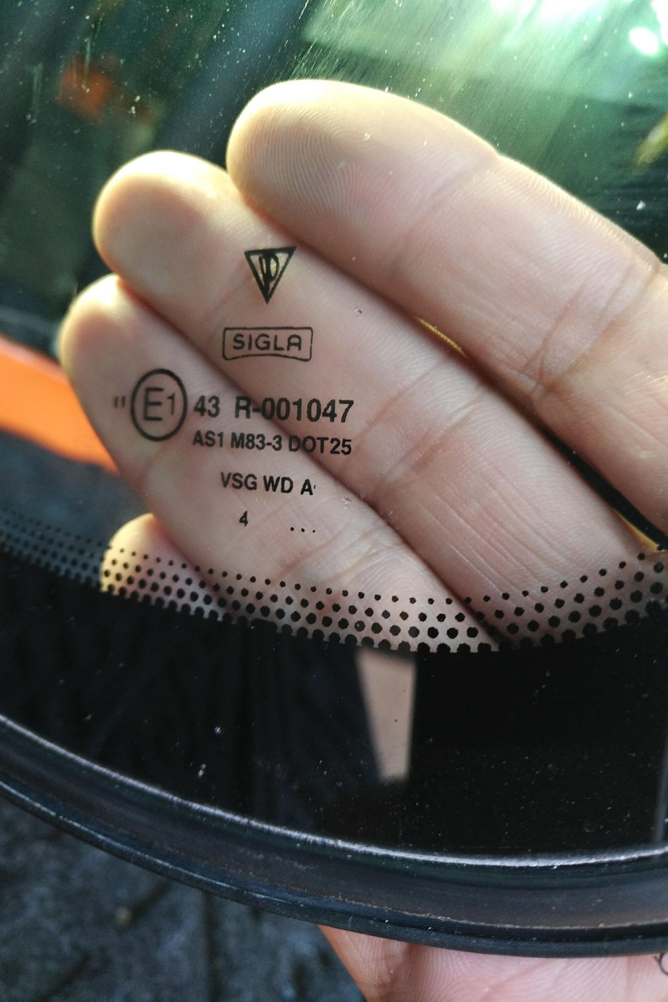

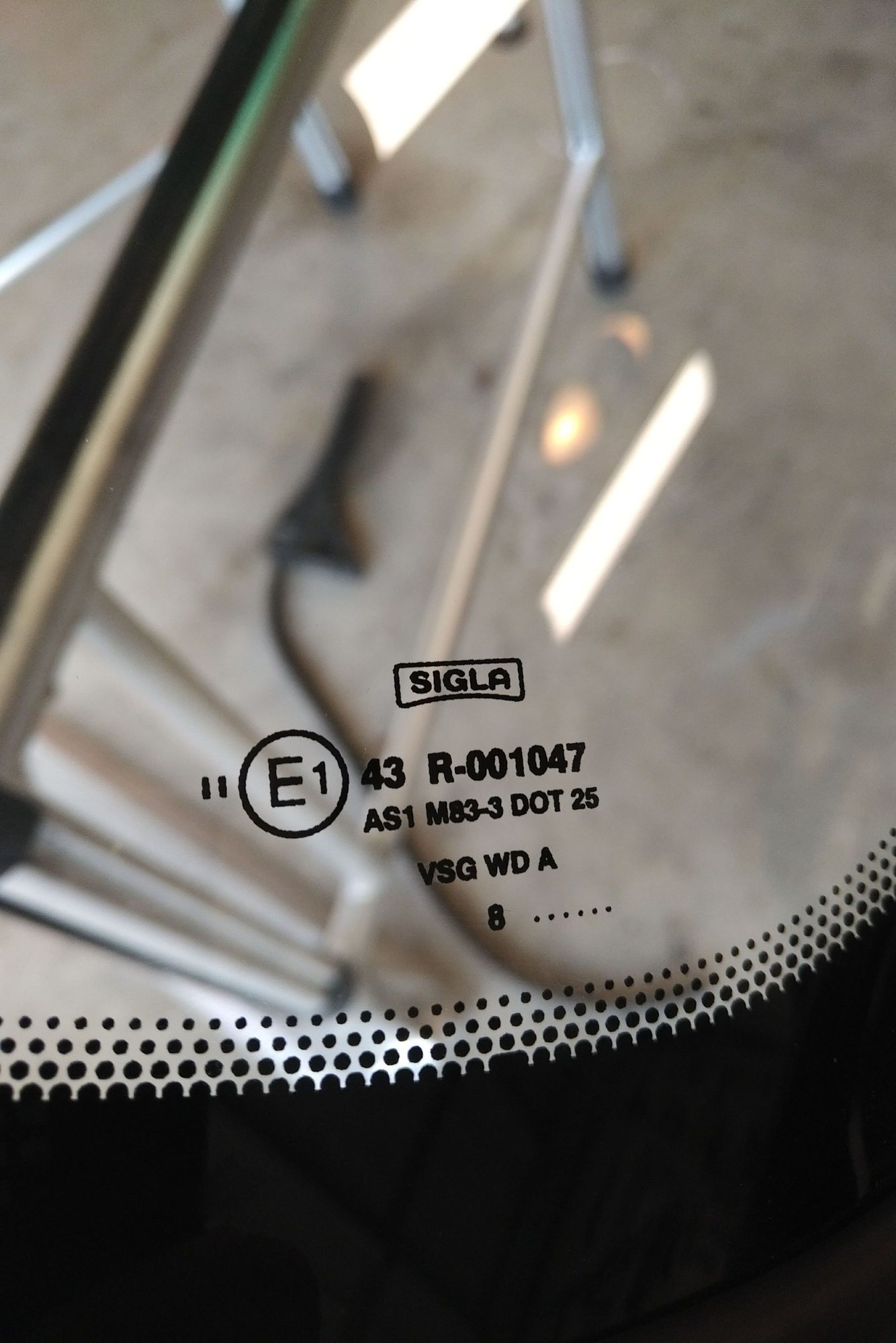

Here are some pictures of when my windscreen was replaced. Maybe the codes on the glass and closeups will help identify what you have.
New 993 windshield
Genuine Porsche 993 windshield codes
Replacement non-oem 993 codes
Closeup of the channel sans glass

Here we go folks... 964 glass.
I thought I read that the 964 seal gets glued around the glass. Looking at the old, dried up, flakey yellow residue stuck to the inside of the 964 seal, that looks to be confirmed.
Yet this glass is just sitting in the rubber channel without anything. I could easily pull the seal off the glass as you can see.
Sounds like 993 glass and new seals are on the horizon.
