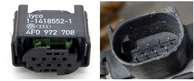

I believe it may be a wiring issue, does anyone have info on the sensor/camera connector and wiring layout behind the bumper?
You can ignore the "Cut existing lines", that's for a retrofit. The connector type is L72A8 (part number 4FO-972-708).
