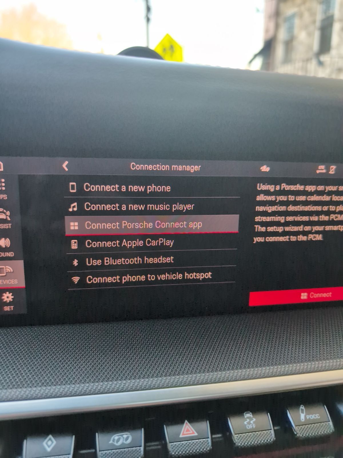

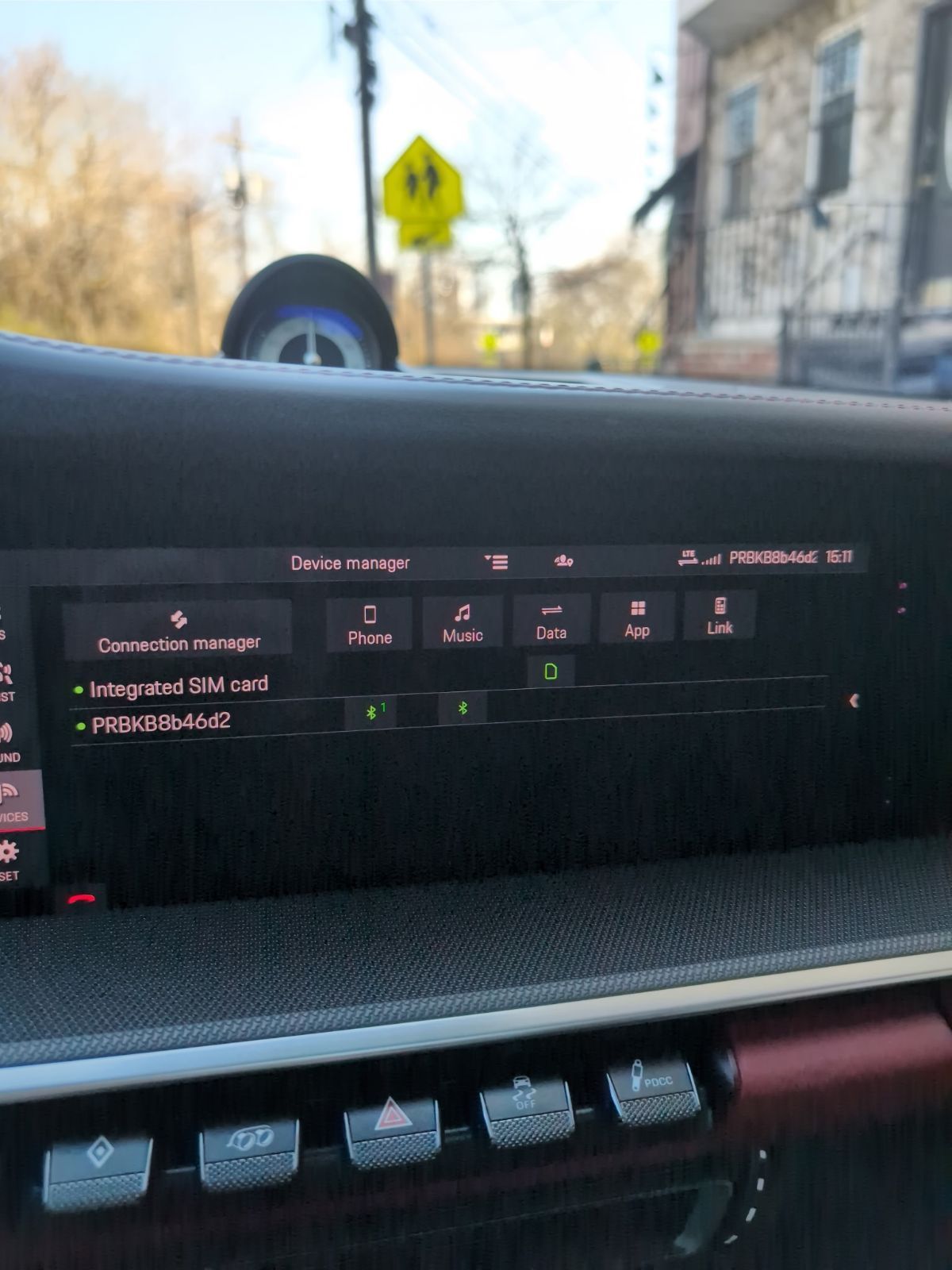

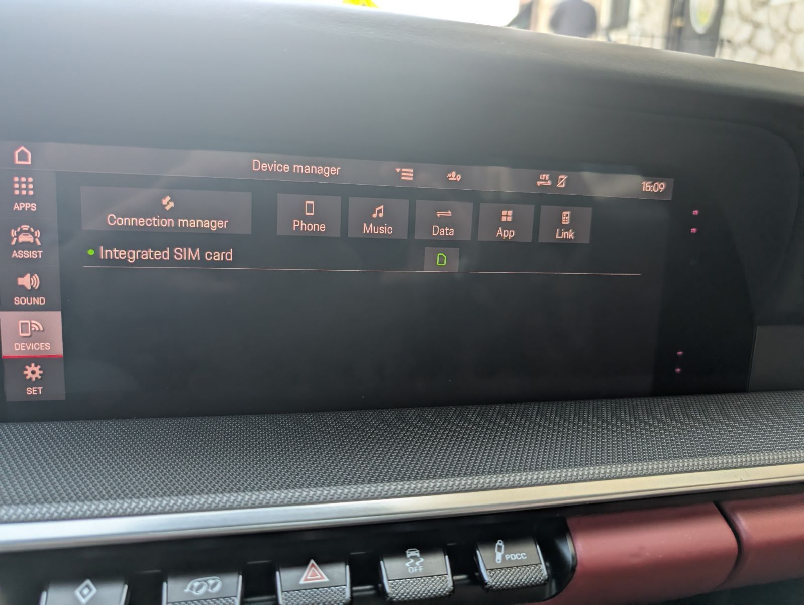

Upload a picture of your PCM.
I'm 99% sure yours does NOT have android auto from the factory..
Only carplay
You have the same PCM style from the current Macans.
Which does NOT support android auto.
2022 they went to the "taycan" style which came with android auto.

Thanks a lot! Here are three pictures I took several days ago.
Porsche service even has no solution to his and cannot help me solve the issue
