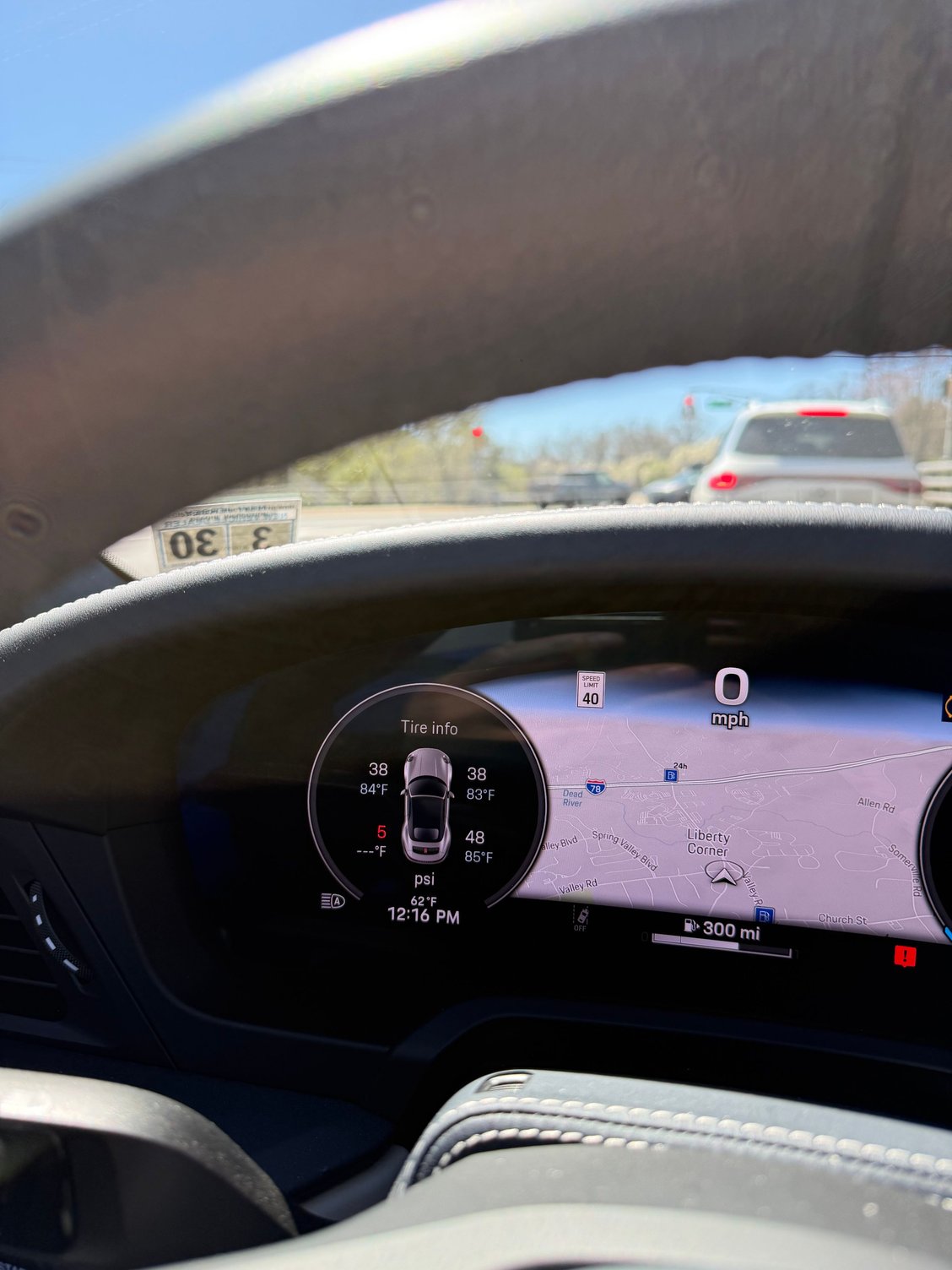

So on Friday I got a TPSM alert with bizarre pressure numbers that didn't make sense including a negative LR number (see pic). At the time, the LR tire in question was a little low on air (checking with a tire pressure gauge) and I was planning to top it off when I got home until i sorted it out. Tire was flat by then, not sure if it was a puncture or from a pothole. Checked another TPMS screen on the dash and that info was correct (see pic). Has anyone else seen this?

The reason it is reading negative is because that is the amount it is below the target psi. Your front tires are +5 psi, your rear passenger is +8 psi, and you rear driver is -37 psi from the target psi, which itself varies depending on what mode you have it in (comfort/full load).

each of your displays is showing (correctly) a different thing. The right one is showing deviation from target (hence the negative), the left one is showing absolute pressure (hence all positive with one super low reading)
