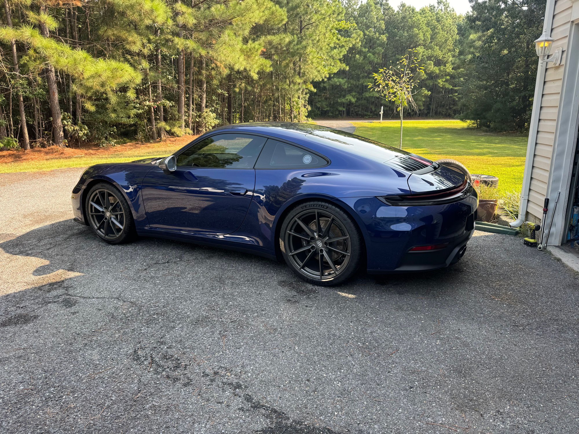

Yes they will. Essentially it's like putting on a 12mm spacer on your .2 wheels. I have a set of .1 wheels that I've put on my .2 Carrera T. The TPMS are different though. So if you buy a set of wheels with .1 sensors, they might not work.
