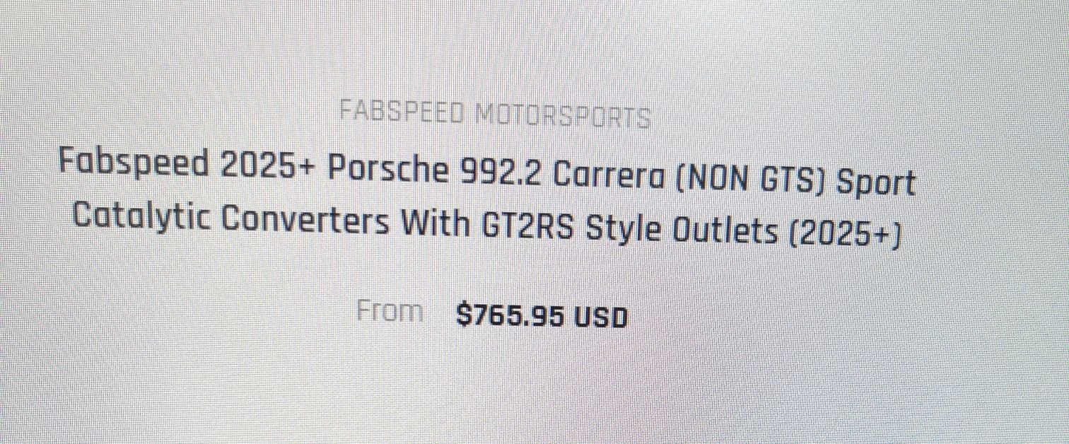

Fact 1: For $795 I can get the Fabspeed Sport Cats: https://www.kiesmotorsports.com/prod...e-outlets-2025
Fact 2: For $795 I can get the DO88 intake system: https://www.do88performance.com/en/a...mm-airbox.html
Fact 3: For $4,855 I can get the Soul Sport Cats: https://www.suncoastparts.com/product/por9922scc.html
Question #1: Why the price difference between the Fabspeed Sport Cats vs the Soul Cats?
Question #2: Would I get better performance for $1,600 installing both the Fabspeed Sport Cats AND the Do88 intake pipes, or spending near $5K on the Soul Cats?
TIA!

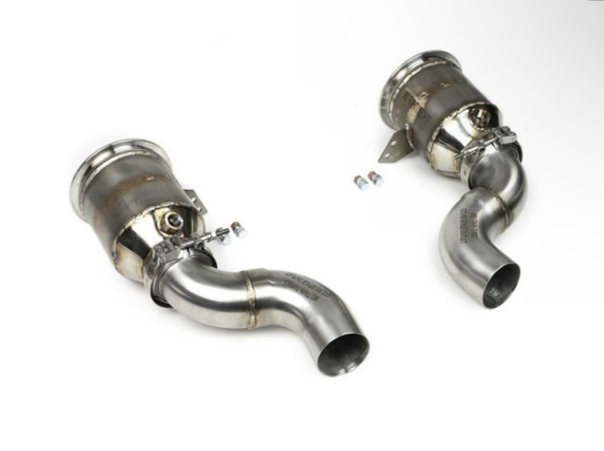

Expect to spend +/- $4k for a set of cats from a reputable source that uses GESI or HJS cores (…with either ceramic or metallic substrate; the latter more robust).
If would recommend going to each vendor’s website for a better understanding of the set of possible upgrades across the entire exhaust system.
After you decide which parts you want to upgrade, then you can see if there are pricing differences at retail.
Soul Performance:
https://soulpp.com/product-category/...2-911-carrera/
Fabspeed:
https://www.fabspeed.com/porsche/911-carrera/992-2-2025/
Upgrades appear to be available for:
— headers (exhaust from engine going into the turbos)
— catalytic converters (replacing 700 cell with something smaller, like 300 cell)
— x-pipe/muffler section
— everything together; a multi-part upgrade

The consensus is that Sport Cats alone are not going to make a huge difference in sound...you still have a factory muffler and factory-controlled valves ...replacement of the main muffler system and or independent valve control will usually increase volume.
You have 500hp and have owned the car one week....and it's probably not broken in yet...How much HP do you need and what's your rush?
- High flow Cats alone are not going to provide a huge increase in HP
- DO88 pipes also do not provide a huge increase in HP

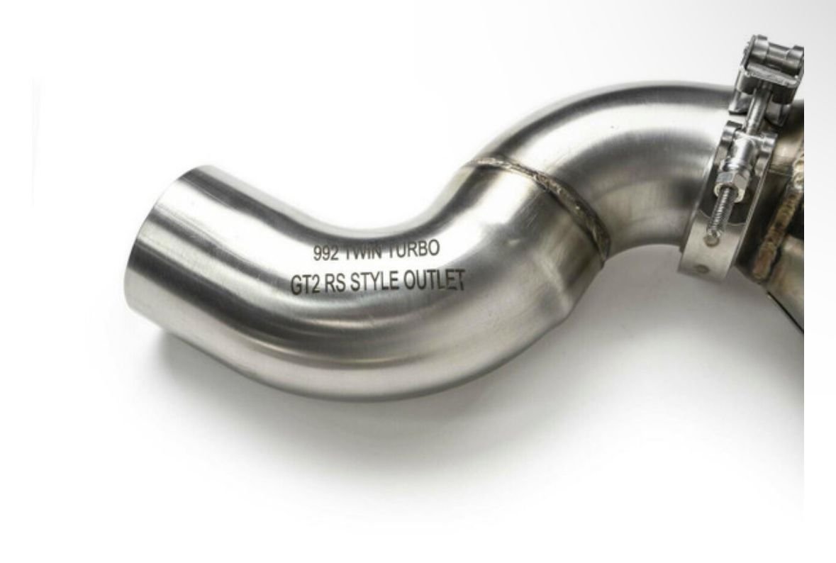

- The $795 price question in your post is for GT2RS tips alone.... not inclusive of Sport Cats
