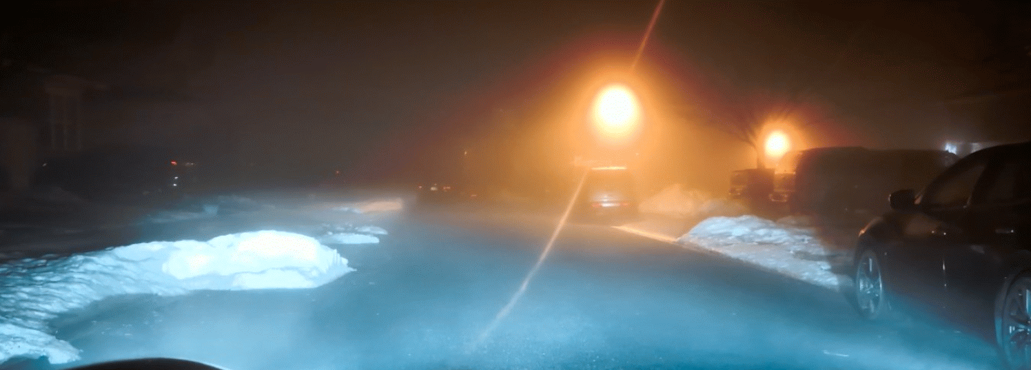

Probably most people know already but if anyone is wondering what the invert headlight function is with the matrix headlights, this is what it does. The pattern where the left is more of a V is with the invert off which was my left hand drive default.

ya it is exactly what it is for left hand traffic vs right hand traffic cause in Europe when you drive from one country to next it is different
