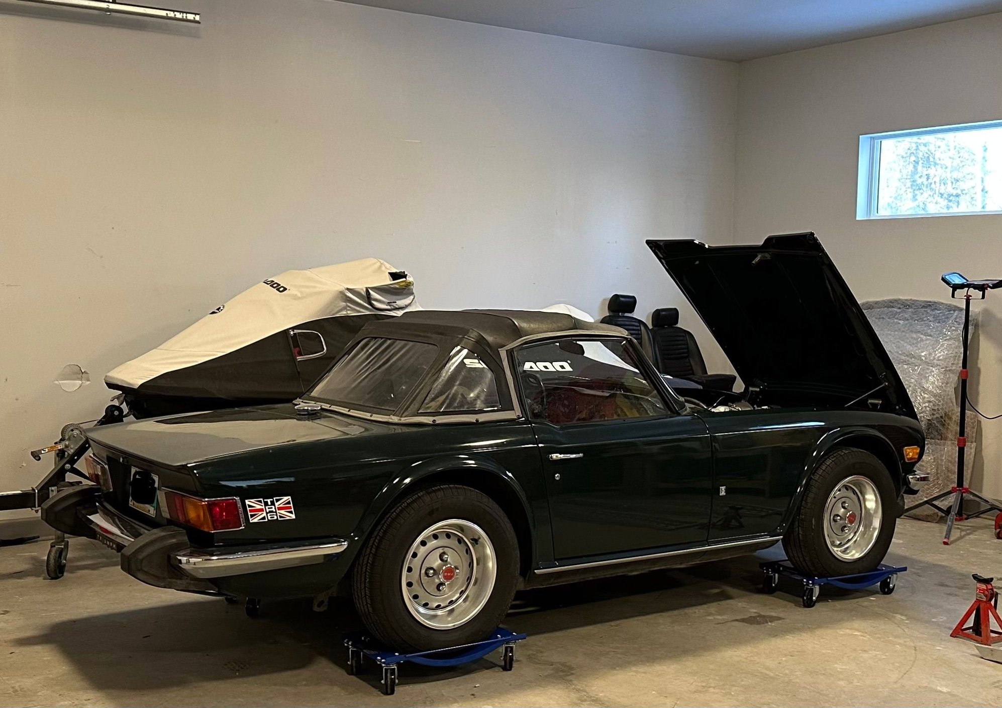

Originally Posted by 3Series
You won't need tire cradles in 2026. If you store the car for a couple months, just increase pressure a couple of PSI. It'll be fine. Tire cradles are from 50yrs ago...
Exactly 50 years ago (1976 TR6).
