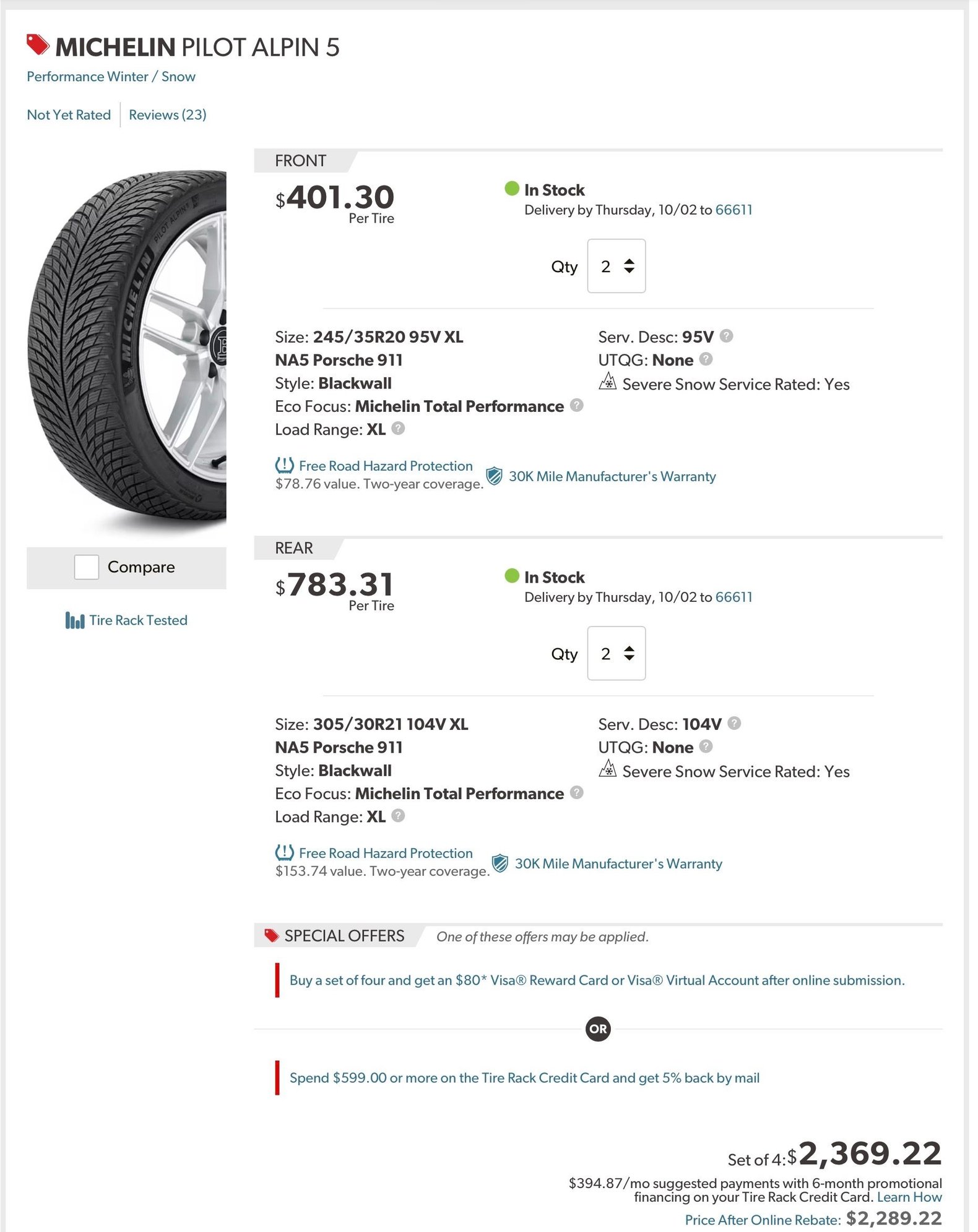

The OEM Porsche Winter Tire and Wheel CENTERLOCK sets for the 992.2 GTS include two tire choices:
— Michelin Pilot Alpin 5
– Goodyear Ultragrip Performance Gen-1
I ordered a Winter tire/whel set from Suncoast that came with Alpin 5s (did not have a choice). I later learned the Goodyear ultragrips were a possibility.
Note the winter sets use a smaller rear tire size: 305 (winter) vs 315 (summer)
Last edited by MartinHines; Jan 24, 2026 at 11:51 PM. Reason: Updated to note these are for Centerlock wheel sets

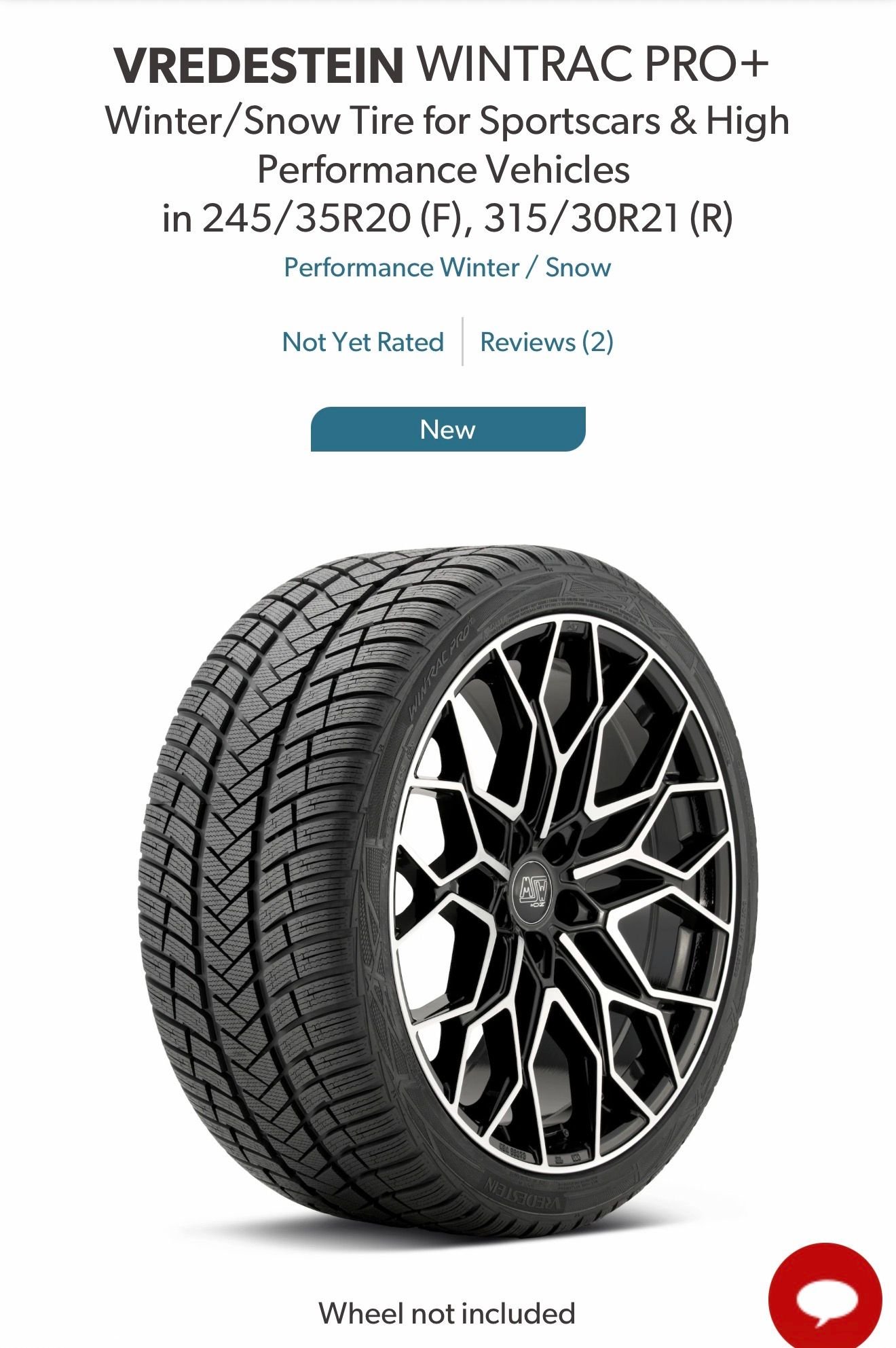

I am running these on my 992.2 GTS on oem centerlock and I have been very pleased with them.
Excellent grip in the snow and no issues at all with the cold.

+1 on those tires as they are amazing. Had them on a previous car and they performed very well.
