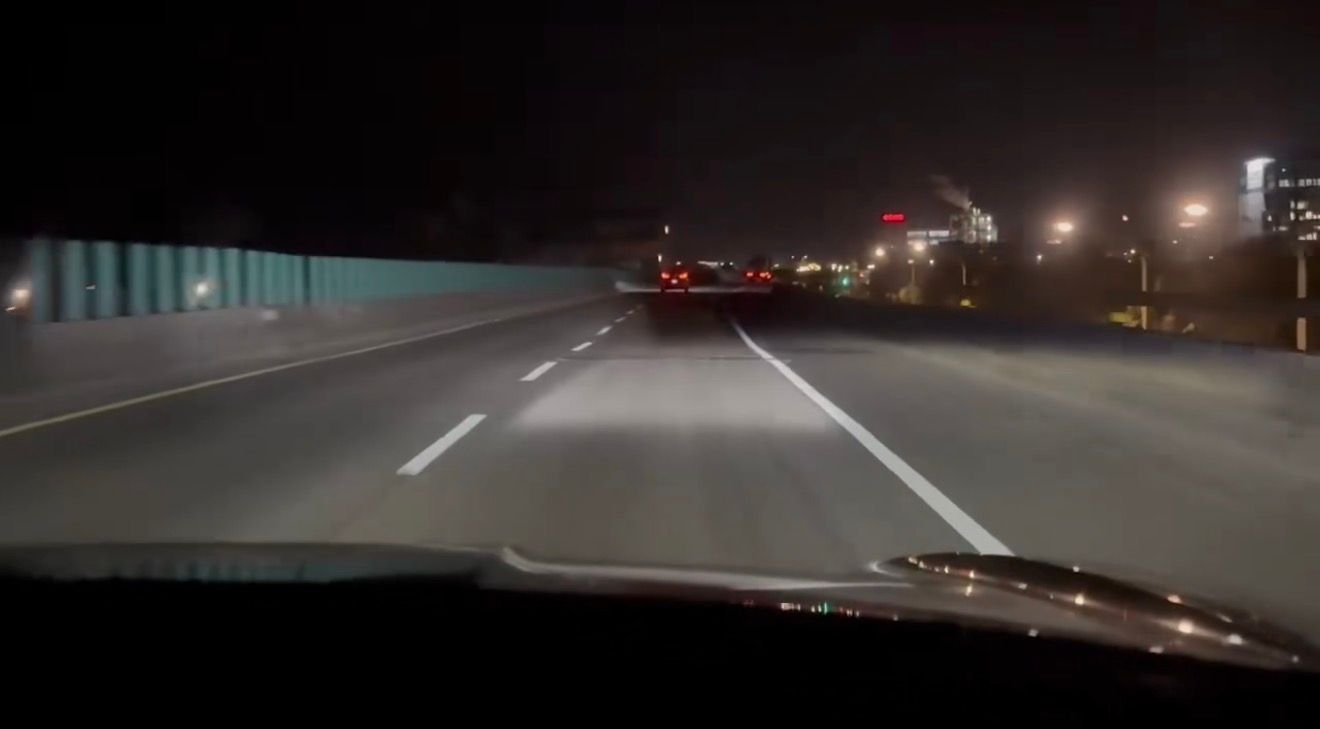

3️⃣ “Illuminate Lane on Highway”
(HD Matrix only – typically 2024+ vehicles)
This is an additional HD Matrix feature, not available on standard Matrix LED.
Lighting menu showing additional lane illumination options (EU reference)
Lighting options visible on EU-spec vehicles equipped with HD Matrix (reference only)
What it does:
  • Enhances lane visibility without increasing glare for other road users
HD Matrix lane illumination behavior
Lane-focused illumination behavior as demonstrated in EU markets
Highway lane illumination concept
Highway lane illumination concept image (reference)
Important notes:
  • Fully functional in EU / ROW markets
North America:
  • Hardware and logic are present, but region-locked

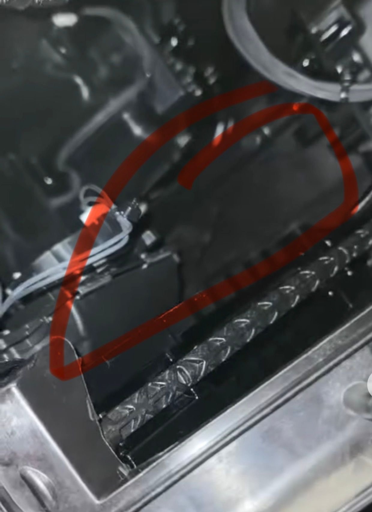

Just to clarify from a technical standpoint:
Matrix light activation can be performed remotely on U.S. vehicles when the required hardware is present. Where things become more complicated is model year 2024+.
Based on VIN checks through the Porsche parts catalog, Porsche introduced a different headlight specification for some North American vehicles. These units are visually similar to Matrix lights but are not HD Matrix and are missing certain internal LED modules.
Because of that:
  • The system will attempt to initialize full matrix logic
  • It will look for those missing modules
  • Since they are not physically present, errors occur
  • Basic lighting still functions, but true matrix features cannot operate
This is a hardware limitation, not a software or coding issue.
For vehicles equipped with HD Matrix headlights, there is no such limitation — those have all required modules and work as expected.
For non-HD units, the only way to confirm is by VIN and part number verification. We’ve already seen this on a small number of vehicles, including two Cayennes.

Default Major Findings
Major Findings
• The issue does NOT affect all vehicles — it appears only on some 2024+ North American builds
• Certain NA-spec Matrix and HD Matrix headlights differ internally from EU/ROW versions
• Some assemblies are missing specific LED segmentation / driver modules drivers
• Externally the lights look identical
• Standard low/high beam operates normally
• Full matrix initialization fails only when required segmentation modules driver are physically absent
This confirms that in affected builds, the limitation is may relates to hardware specification dependent, not purely software-related.
Practical Implication
Before assuming matrix activation is possible, it is important to verify:
• VIN
• Exact headlight part numbers
• Whether the vehicle has full HD Matrix hardware or a reduced NA-spec version
Only some builds are impacted, so VIN-based verification is the safest approach.

Technical Update – Root Cause Analysis for 2024+ NA Matrix / HD Matrix Headlights
We would like to share an updated technical finding regarding the 2024+ North American 992 / Cayenne Matrix and HD Matrix headlight activation issue.
Following additional bench analysis and vehicle testing, we can now confirm that the earlier assumption of missing hardware is not the actual root cause in the majority of affected units.
Previous Observation
During initialization and coding attempts, certain 2024+ NA-spec Matrix / HD Matrix headlights reported behavior consistent with incomplete hardware configuration.
Typical symptoms included:
  • matrix initialization failure
  • diagnostic feedback indicating missing internal segmentation / driver support
  • coding not being accepted correctly for full matrix functionality
  • standard low/high beam remaining functional while advanced matrix functions failed
Based on the initial diagnostic output, these units appeared to behave as though specific internal driver stages or segmentation-related support were physically absent.
Updated Root Cause Finding
After deeper investigation, we have now confirmed that the hardware itself is generally present.
The actual issue is related to the firmware state and internal configuration of the headlight control modules.
In the affected headlights, one or more modules do not contain the required firmware/configuration set needed for full matrix feature support. As a result:
  • the module reports an incomplete capability state
  • the diagnostic system interprets this as missing hardware
  • vehicle-side coding logic rejects or limits matrix activation
  • the fault appears hardware-related, even though the physical hardware is installed
In other words, the diagnostic path is being misled by the module’s firmware/configuration status.
The “hardware missing” conclusion comes from the module not correctly identifying its own available function set.
Technical Interpretation
From a diagnostic perspective, the control path is not simply checking physical presence in a direct way.
Instead, the system appears to rely on module-reported capability and firmware-defined functional availability.
If the expected firmware package / configuration dataset is not present, the module does not expose the required matrix support correctly, and the vehicle interprets the condition as unsupported or incomplete hardware.
This is why:
  • the external lamp assembly appears correct
  • standard lighting functions operate normally
  • full matrix-related initialization fails
  • diagnostic tools suggest absent hardware even though the assembly is physically equipped
