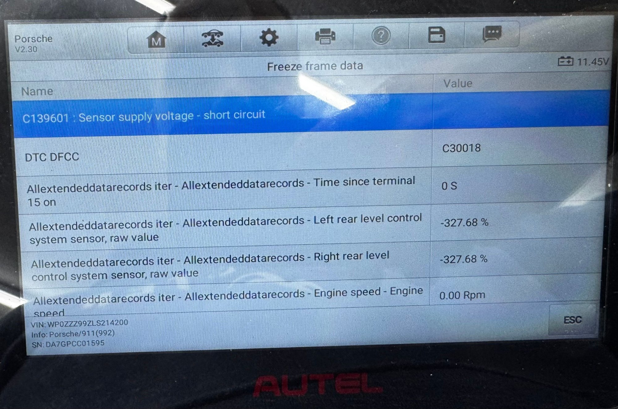

I’m hopeful someone can point me in the right direction to track down a couple consistent error codes reported by my Autel on my 2019 C4S.
1/ PASM Module - ‘C139607 Sensor supply voltage - short circuit’ I see no indication as to what sensor.
2/ Instrument Cluster - ‘B199101 Lvds interface, electrical malfunction’ Code cleared after a visit to Porsche for a recall but after battery swap it’s back and can not be cleared.

Update
The short circuit error was from the rain sensor and the LVDS error an issue with the dash digital display, a small line that’s barely visible. Replacing just the screen seems possible with one from Temu
