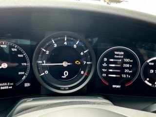

My 2024 992.1 CS Has been in a car storage facility for 3 months, they use trickle charges, check the tires etc, climate control etc. It has less than 4K miles on it and had it's first service 2 months prior to service.
I went today to take for a drive and the notified me that the check engine light was on. I took it for a drive and everything seems ok, drives normal and no other warning lights
Any thoughts? Was thinking of getting a OBD2 reader before taking it to the dealer. Any thoughts on a good reader?

since it's under warranty I would just take it to the dealer

The battery may have discharged to too low a voltage. I had a CEL for the same reason, but it cleared itself after a few drives and lock/unlock cycles.

You need to get that code read to know exactly what is happening. Some device didn’t provide the expected value. My guess is that it is emissions related and that if you drive it under varying speeds and loads it will go away. Hard to say though.
Agreed.
Same happened to me.
Clears in 10-15 mins of driving.
